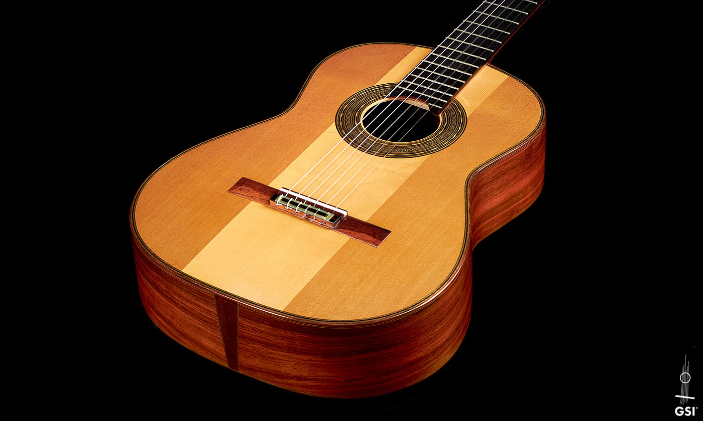

Torres frequently used 3 piece soundboards for the simple reason that quality spruce large enough for guitars was hard to come by and expensive in 19th century Sevilla and doubly so in Almeria once he moved back in the 1870's. An interesting aspect of Torres' multi-piece tops (which appear on his simplest and most expensive instruments equally) is that he appears to have used the stiffest piece of spruce in the center of the top under the bridge while the two outer pieces tend to be less stiff and sometimes off quarter. The Italian maker Andrea Tacchi noticed this phenomenon after handling a few Torres guitars and created his "coclea thucea" model to expand on the idea. He uses alpine spruce under the bridge and cedar on the outer sections with great results

I think that depends, the steel string market tends to be more conservative about guitar construction while classical players have easily embraced double tops, lattice bracing, and many other modern features. Andrea Tacchi has a decades long waiting list for his very bold (and very expensive) 3 piece topped guitars
