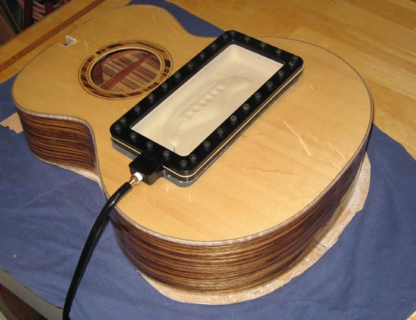

Vacuum!
-Dennis

Bob Garrish vacuum bridge clamp!!!!! Fast, tight and can't be beat

Once you use vacuum, you'll never go back! I use the one from LMI:
