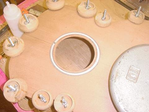

Im posting these pictures for Stan, He'll chime in and splaine!

Nice top on that guitar...! Is that redwood or cedar?

don it is your fine redwood. have we finished the transaction yet haven't see it in bank statement
PostPosted: Mon Jan 03, 2005 1:18 pm

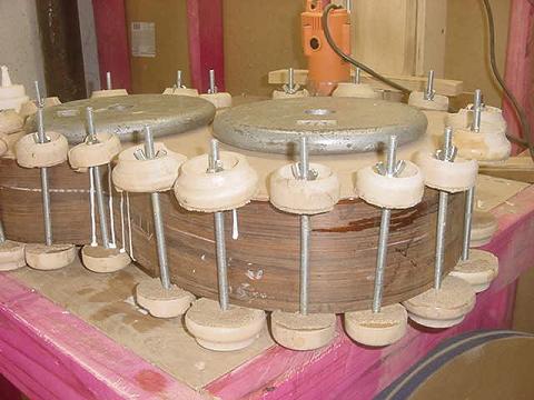

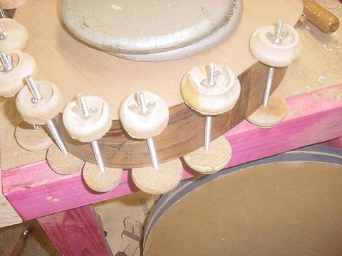

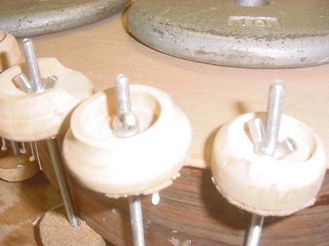

I'm guessing that top is Western Red Cedar. By golly look at those spool clamps. Stan you have to have Italian blood in ya to use spool clamps. I can tell they are working cause the glue is squirtin' out. That only means one thing, you have good contact between the mating surfaces.
The weights make a sure augment of the spool clamps too. Great job. Bruce

PostPosted: Mon Jan 03, 2005 3:16 pm
Posts: 731
Stan,
Cool! I used spool clamps on my kit guitar, and I used iron weights on my 1st guitar! They seemed to work great for me too.
Jeff
PostPosted: Tue Jan 04, 2005 1:09 am
Hi Stan,
Looks like it works real well. I use a bunch of cam clamps but have often thought that the violin type you use would be lighter and every bit as efficient. Aren't you worried about the weights? I just look at my tops and they seem to scratch!

Dave, just set some paper towel under them, tell you truthe it was the first time i put the weight on. I do have some room for sanding scratches out

Great method Stan but what's up with the PINK bench??? You're not going "gurly man" on us are you? [just kidding].
Bruce mentioned seeing the glue running down the outside and it only makes me wonder what is happening inside? Glue drools are reeeeely hard to clean up once the box is together (don't ask how I know). That's one of the reasons that I alsways invert the box and glue the top or back in the opposite position as this counteracts gravity.
tim...
PostPosted: Tue Jan 04, 2005 3:38 am
Tim, cool idea gluing with the top or back down, never thought of that. I just practice getting the right amount on the rimset. Once you get a feel for how much glue there should be, it doesn't do this. I think Stan will agree it would be better not to have to clean off dried glue from a guitar body. And as you point out, getting one to go away on the inside is nigh impossible.
Knock knock knock on wood, I've never had one yet. I've had some tiny beads of glue and maybe a glue line around the outside rim, but the lining slots seem to accept excess in the inside. It's fun getting it really close and still have a good glue job. That is one of the things that you learn as you move up the luthier ladder, huh?

Tim I wanted to be a "metromale" but it just didn't work out. Lowes had these reject studs for sale at a $1.88 a board. The glue is a thing I at times struggle with. I can get to much (like in this) or then back of and not enough. On this one, I bit the top of bottle like Mayes and when gluing in started coming out the side of the nozzle also. Normally wipe it clean first. I am going to do the invert thing though from now on thanks. I normally don't have weights on top, but when I glued it first time, glued top to back side of rim and then had to remove it an do it again. Just one of those shop things of don't work distracted or tired and in this case no glasses and to fast

Stan: Another tip is to lay the back (if that is what you are gluing) on your dished form with the braces facing up. Now place the body on the back and draw a line around the outside perimeter of the guitar. Now run a bead of glue just inside of the line. Spread the glue with your fingertip so it just touched the line. The bead will now be about 3/8" wide. Now place the body on the glue bead and clamp away. I use a go bar deck and find this is faster than spool clamps but to each his own.

Stan, I just realized by looking through the soundhole, that this is just the top gluing, no back. Do you have a picture of the completed box? Thankx
