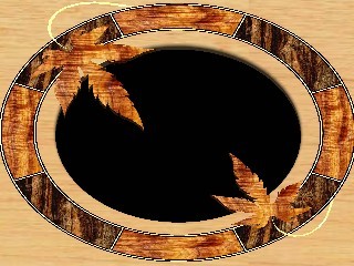

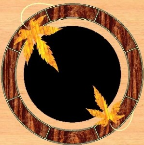

I am building the second in a series of OM's with a Japanese Maple leave vine scheme. The guitar will be Black Acacia B&S, Caucasian Spruce top with IRW binding maple/black maple/maple pufling, both sides and top edges. On this one the leaves will be Mahogany and the vine will be Maple. I am stuck between these two rosette designs. So I am requesting your assistance and will bide by the out come of this poll. R1 is Black Acacia and IRW main ring, R2 is IRW main ring each are purffed with black maple/maple/black maple

Personaly I think #1 may be just a little too busy (although it is nice too) and I think I might make the ring a little narrower. How do you support the overhanging leaf. Hey your design is great!!! John How38357.6315740741

Micheal both are just great. Send them to me on tops ready to go and I will let you know. I don't know how you could go wrong either way. I guess if choosing, the one with the rw and maple. These should be outstanding

MP, they are both very nice. I personally like both. However, I'm voting for the R2 so the light wood doesn't distract from the leaves which is the unique design element.

Michael are these pictures or photoshop creations?, I like the first one better it has more interest with the color variations in the ring.

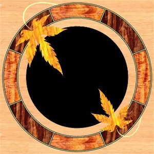

Michael, can you try one for me? Do it just the same design, but use only two woods. R1, but change the leaves to Koa on the EIR background and see what that does. John's comment made me think about busy-ness. See if dropping to two, rather than three will work? Just a thought.

I sent a road trip guitar out last year with a rosette very similar to the design on the left except it had 12 segments of alternating woods. The concensus was it was to bold and distracting and it did not appeal to the masses. I like both of your designs but the second choice may be a better one based on my feedback.
Another thought is to consider adding a third leaf. Groups of odd numbers are easier to balance and are more asthetically pleasing.Tim McKnight38357.9117361111

Michael, I very much like the looks of both rosettes. I lean more toward (and voted for) R2, because the ring is less busy, and less distracting to the main object, the leaves. I personally feel the two leaves balance nicely. Good composition.
PostPosted: Wed Jan 05, 2005 10:11 pm
I have to agree with Steve, the 2nd one does help draw more attention to the leaves (more Japanese maple?), but for some reason I voted for the 1st one anyway. I like the contrast of the different rings. Now that I look again, the 2nd one may be a better choice. So just move my vote over to number 2.

I voted for R2. A third element, such as another leaf definitely makes it easier to achieve dynamic balance in a design. Have you considered letting the leaves (or just one of them) overlap beyond the rosette and into the top itself?
"Outletting" the leaf would be a pain in the arse, (just testing the filter). Especially since you'd need to add a thin line of dark purfling to define the shape against the light colored wood of the top. But it would offer you some additional options for balancing the elements. It also would add yet another bold stroke in an already daring design.
Interior access is another consideration. I'm assuming your truss rod will adjust at the headstock, so that wouldn't be a problem, but access for future repairs or fitting a pickup might be tricky.
If I were doing this, and the idea is so attractive I may be compelled to attempt it someday using oak leaves and acorns, I'd consider building the guitar with an access panel. It's radical, but Boaz Elkayam and some others have done it.

Of the two, I like the right one more. It's less busy. I also think that the leafs shouldn't cantilever over the sound hole like that. Turning the arround and haveing them inlayed into the top would look just as stunning and be much safer.

I went with R2. Both would be stunning.

[QUOTE=Dickey] Michael, can you try one for me? Do it just the same design, but use only two woods. R1, but change the leaves to Koa on the EIR background and see what that does. John's comment made me think about busy-ness. See if dropping to two, rather than three will work? Just a thought.[/QUOTE] yep I will post later today.

[QUOTE=Dickey] Michael, can you try one for me? Do it just the same design, but use only two woods. R1, but change the leaves to Koa on the EIR background and see what that does. John's comment made me think about busy-ness. See if dropping to two, rather than three will work? Just a thought.[/QUOTE] here is the requestd change Bruce
PostPosted: Thu Jan 06, 2005 2:30 am
IMHO I like that one best.

R1 with EIR and Black Acacia alternating ring. Then use Black Acacia leaves on the EIR part of the ring. Cuts the design back to two woods.
Also I have a question: In the first two examples you show the leaves as mahogany? Is this an actual mahogany sample? Appears very yellow for mahogany. If the yellow wood isn't mahogany, what wood is it?

here you go BD...I turned it at a 40deg angle to show some depth
PostPosted: Thu Jan 06, 2005 6:48 am
Just wanted to see them all together. Hmmm, what do you think now? Might need a new poll? Nice.
