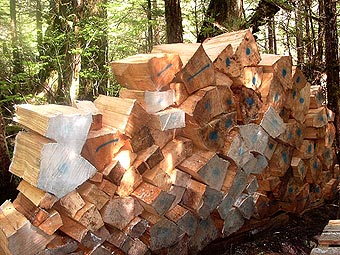

I'd be in for a bunch if it pans out to be as good as advertised. BTW, what's the difference between a billett and a bolt?

A bolt is just a short log. These he has are hand split chunks, so not a full round. A billett is a smaller cut or split usually rectangular-ish piece.
Here is a stack of his bolts

Wow... this is great. If their quality is good this is fantastic.

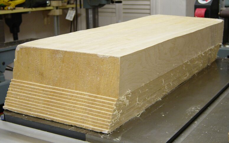

Converting bolts to tops can be more work than you might guess as I learned when I resawed a half cord of Engelmann into tops a couple of years ago. It helps if you have (or can rent time on) a 12" jointer so you can level one face quickly (I did them with a hand plane).
If the billets have any appreciable twist, it becomes more challenging. And realize the downside of buying billets -- if you unearth a big knot right in the center of this thing, all the work is for nuthin'.
That said, it can be kind of fun. Just don't necessarily equate cheap billets with cheap tops, unless you do not value your time (I know I sure don't)!
When they have no twist (like the Sitka billet below), it can go pretty easily...
