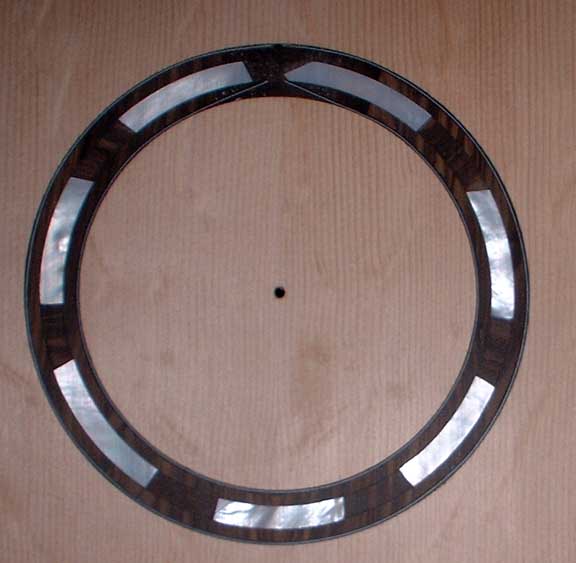

It is indeed MOP. I inlaid a 3/32 blue abalone 1st, and then managed to sand through it! So I routed it out with a 1/4 bit and now what I have left is 1/4 MOP. So it is good to know that hiding the joints is next to impossible. I will have to figure out what to do now.   Might try MOP, wood, MOP.

White MOP. OK forget my first post, I was assuming it was abalone. As people above sugested come up with a design that uses the joints.
PostPosted: Wed Apr 27, 2005 12:40 pm
Posts: 731
Hopefully it does not look to bad.
Jeff

PostPosted: Wed Apr 27, 2005 12:53 pm
Great job Jeff.
PostPosted: Wed Apr 27, 2005 1:12 pm
I've done MOP and I really like it. Sure you can see the joints, but not
many people think the rosette is all one solid piece of pearl anyway so it
is no biggie...
