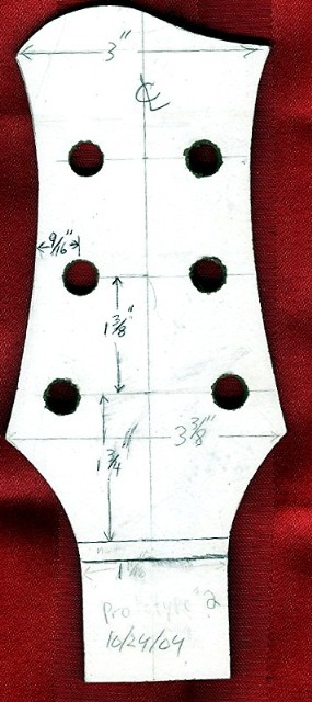

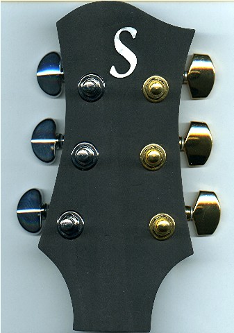

When doing my designing, I had 2 sets of extra tuners available that I thought I might use. I also made a couple of headstocks out of available wood, even put a black lamination on one. I put one Grover tuners on one side, and Goto on the other. Since the sides of my headstock curve in ala Olson, the grovers were just a little tight.
I have spacing dimensions, but I can't post em right now. The pix says it all. I'll get that for you too, later on.
A set of French curves comes in handy. For symetrical headstocks, draw a ctr line, and just draw a half template for accuracy. Asymetrical, draw the whole headstock. Again, pine mockups help tremendously.

I agree, all great points. I spent lots of time tweaking, and learned a few layout principles.
Make a few out of Masonite, put the tuners on and play with it. Those french curves really help. I made 5 of these prototypes, and two from real wood, and I'm close to arriving.
My brother put my one into Autocad just to clean it up. Will post a few pix later(gotta scan, a couple, etc)

Here's a couple I did for the sake of practice, just for the experience. I measured a couple guitars for nut to 1st tuner (1 3/4"), to next tuner (1 3/8"), tuner ctr to outside edge (9/16" in this one). The template and mockup are NOT the same, but close.
As stated before, proportions are critical. Keep in mind that if you're binding it, the curvier it is, the more challenging it is.

BTW, having mounted the two types of tuners I was considering mounting, I found that the Grover buttons were a little close to the headstock on the E and D strings on the left. The design of the Goto buttons accomodated the headstock curve a little better. Curves are great, just have to be aware of design elements.
Make those mock-ups!

Thanks for the help Everyone!
Terry, those pictures really help me visualize the process. Thanks for posting them, that will get me off to a good start. Much appreciated!
