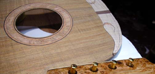

Walter,
I didn't find it any more difficult than any other figured wood. Just take it slow and use sharp bits.
Lance had a demo of this earlyer and I fallowed his lead.
The center of the rosette and head plate in the forground is cherry burl.
Wade

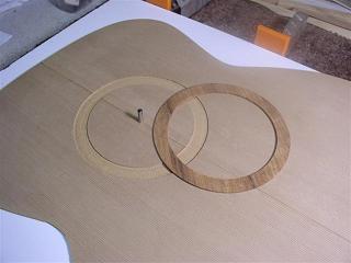

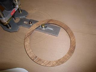

Lance, how deep is your rout
PostPosted: Tue Apr 05, 2005 1:20 am
Posts: 8553
about .050 -- same as a typical shell rosette inlay.
