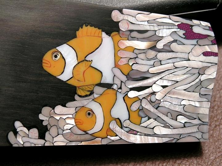

love the clown fish head stock Craig your my hreo

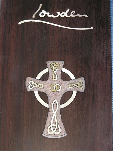

Very nice Craig... I always like seeing your eye candy.
What is up with the symbols? Are they just decorations or does that mean something?

Brock, that's a Celtic Cross. George Lowden is from Belfast.

Thanks Lance, Micheal..
The cross is only 2.5 inches tall, and including the seperate cut pieces for inside the knot loops, it actually a 47 piece inlay. It looks way more simple than that doesn't it? Materials are sandstone corian, and gold pearl, and a piece of pink mussel at the base. The idea was wedding knot, set in stone. There's more of a theme than first meets the eye. It's a gift fo the client's wife, so I hope she loves it. There is a Celtic knot with a heart in the center going into the 12th fret as well, but George wants to inlay that himself as he finishes off his fretboards in a certain way un-condusive to any inlay going in until last. I pre-cut it and sent him the pieces.
The clownfishes are about 167 pieces, the anemone is all different shades of pink mussel, three pieces of black pearl, and a few pieces of purple sugalite for the anemone base showing through. The fish are gold pearl, spiney oyster, and white river pearl.
That's the headstock to the moorish idols and turtle scene I posted a while back. That's my ASIA guitar for this symposium. John K is doing the guitar, and as of now there is still a 250 piece leafy sea dragon almost fully cut for the back. It's going to be a routing nightmare.

The Lowden is for Lowden guitars of Ireland. It's a custom build from George's newest production run facility I think.
I have done inlays for both. George's personal shop (hand built by him) and now for Lowden Guitars. As evidenced by the logo. The logo was CNC'd. It was on the headstock when I got it. This is actually the second time around for this cross. I did another version of it, larger, with different materials and a diffeent knot in the center. I was unhappy with it, and asked George if I could do it over. These are the the results.

Craig, that is some incredible inlay!
Do you study fish? It can't be easy to get such lifelike inlays without knowing quite a bit about the subject.

Dave, I have a degree in marine biology, as does my wife, she has her doctorate in it. But the more I look at art at all, the more you HAVE to study an image to get the effects you want. When I met Grit Laskin at ASIA two years ago he lectured on design. I already knew what I liked about his art, and what ideas I wanted to emulate. Things like making an image large enough to capture the details. Too small and you lose alot of what makes something what it is. Most times I will let the image go outside the boundaries of the guitar, like Grit does, so I can enlarge an area enough to get the details in, like the clownfish above.
