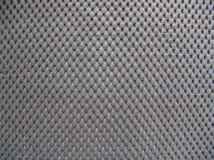

JJ I rub the guitar all over for hours with one of these silicon impregnated drawer liner pads and then finish the neck and body together........
Sorry folks - private joke.....

Ohhhhh...the horror of it all!
If you ever stop using that stuff, you just might become a good little luthier some day!
