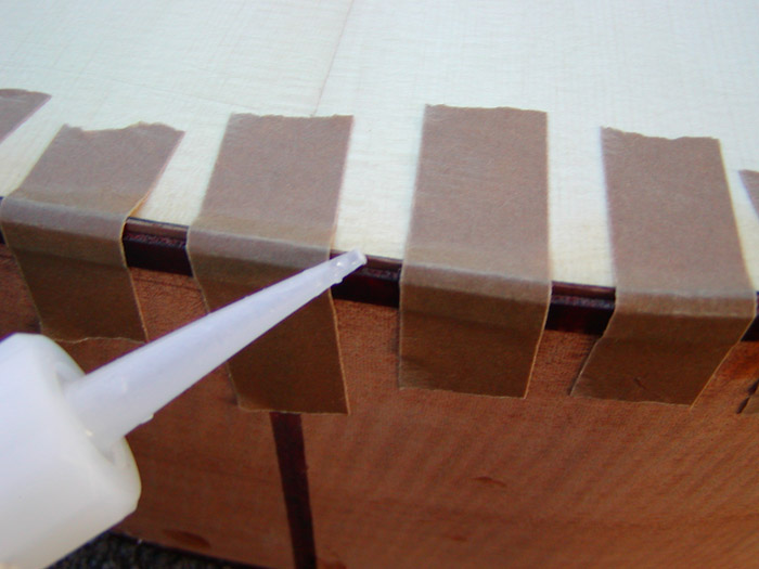

I taped on the binding and purfling scheme with LMI's binding tape, then
dropped Hot Stuff's thinnest CA in the spacings. Trust me, it works. It
took me FOREVER to remove the binding in order to redo the purfling,
trying to slice it off with a razor blade.

Mat, the CA method works very nicely. Don't fear...
 The nicest thing is you clamp everything 'dry. No glue. so, you take your time, get it right, then wick-in a bit(a bit!!!!!) of CA in between the pieces of tape, without accelerator. I like a medium, I guess. I used to think my favorite was very thin, until, I found what y'all refer to as thin. yikes!
My CA of choice are the little wee tubes at the hardware store. $2 for 2 tubes. Nice small tip, and doesn't wick-in forever. Grabs like gangbusters... Never had a stain issue, and have been doing the above since 1996. 2 tubes does a guitar...
I have other methods of choice for binding, and choose depending upon difficulty level. I now only use the CA method for the trickiest binding jobs, as the other are faster/easier. But for sure, it'll get 'er done.
