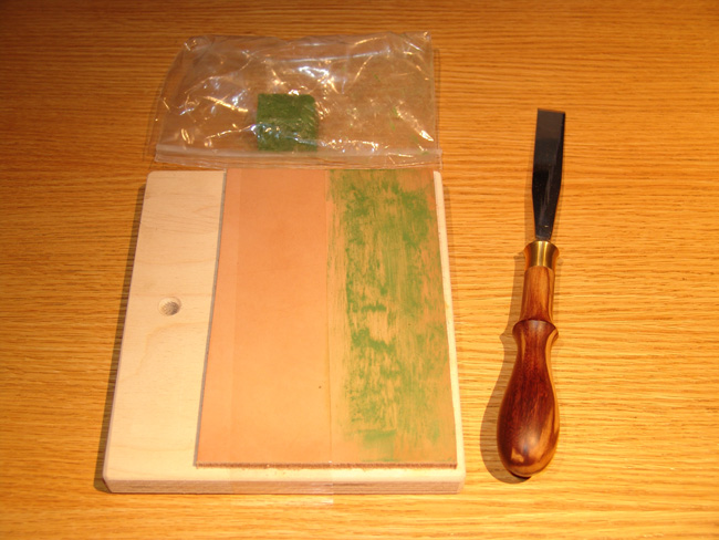

Well my mail person brought me an unexpected box today and I am thrilled at the contents.
The other day JJ and I were talking about sharpening.  I mentioned that typically I sharpen, with wet stones, my chisels and planes after every two guitars that I build.  I also mentioned that I am now able to sharpen to the point where the blades will pop hairs off from the backs of my hands.
JJ asked me if I "stropped."  I didn't know what stropping is/was and he explained it to me that it will prolong the edge on tools.  And then we moved on to another topic.
Today in the mail I received this "hand made"....... stropping station complete with additional compound and some very clear instructions from JJ.  So clear in fact as to even indicate where I might "store" this device when not in use.......  This is why the note is not being posted.......
This thing is beautifully made and more importantly it works like a charm.  I took my favorite chisel and prior to stropping it would no longer pop hairs off my hand.  I followed JJ's instructions, except the part on where I could stick this thing when not in use......., and now this chisel is again popping hairs off my hand.
Many thanks JJ - you are a wonderful guy and a true freind.
Check it out:

Glad you like it Heshie...enjoy!

PostPosted: Sat Dec 15, 2007 10:41 am
Posts: 140
Whats it made from (leather?) what do you use as a polish.
more importantly can we make make one of these at home.
I could do with a new strop
Joel

[QUOTE=joelThompson] Whats it made from (leather?) what do you use as a polish.
Joel[/QUOTE]
Joel-
No doubt Hesh will be along with the details shortly.
I'm still using my homemade strop from years ago- about 2.5 x 8.5 inches, plywood with leather glued to it. For leather, sometimes you can find a wide leather belt or a good quality handbag at the thrift shop. Of course if you have a leathercraft store nearby they will fix you up. For compound, I use jewellers rouge and lately have been trying out the LeeValley green honing compound. Both work.
BTW, LeeValley sells a 1" leather belt that goes on a 1x30 or 1x42 belt sander which you can use for honing. I find that it is 'somewhat' useful for putting an edge on utility knives and the like, but it tends to round over the edge on chisels, so I do the 'good stuff' by hand.

Joel sorry buddy it took me a while to see your question.
Yes you can make your own but JJ made mine so perhaps he will explain how he makes these please?
Also I would need JJ to answer the question as to what the green compound is as well.
PostPosted: Sun Dec 16, 2007 2:45 am
Joel, I can help you out a bit. It's tooling leather. If you need a piece I can send you some. JJ will have to answer the polishing paste question though.
PostPosted: Sun Dec 16, 2007 3:14 am
The green compound is from Lee Valley and it's simply called "Honing Compound".
I'm sure it has a measured abrasive particle size but I don't have that information.
Lillian's right on the leather. I simply glue it (Titebond, I think) to a dead flat piece of 3/4" Baltic Birch Plywood. I put compuond on one side and leave the other untreated. I swipe the bevel and back against the treated side a few times and once or twice on the untreated side.
BTW...NEVER push the blade along the leather...always pull it toward you.

"what the green compound is as well."
Hesh,
It's Green Chrome Rouge. It's used a lot by custom knifemakers. You can also get it at most knifemaker supply places. Google is your friend.

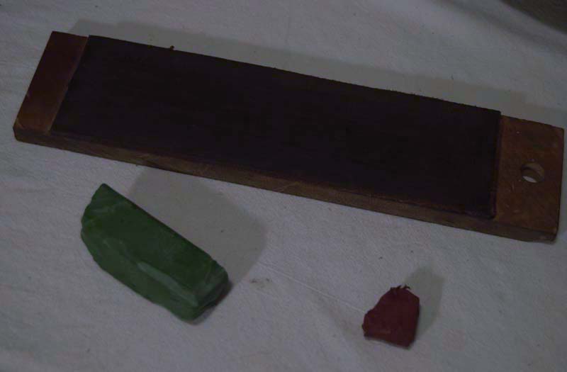

I must say that I'm really quite surprised this is the first time you guys are discovering the strop!
It is one of the most important tools on my bench.  I discovered it via a wood carver freind of mine while trimming my first top to size. He took what I thought was a dang sharp chisel, touched it up with 400, 600, 800, 1000 and 1200 and 2000 grit sand paper in the same manner we level a finish.   Then he took some 600 grit aluminum oxide powder, charged his leather strop with it (by pouring some on the leather) and proceded to put a mirror finish on the blade.
When I tried the blade again, it carved the spruce top overhang like butter and I nicked the side of the guitar.
According to him, the key to the sharpening is to put a mirror finish on the edge with the strop.   As you dull the edge, re poish it and it will be razor sharp again.
I went to an antique store and bought an old (but unused) barber's strop for $12 and now have it clamped to the work bench and use it about every 15 minutes or so.  Just a few swipes and the edge is back.  I use a chunk of extra fine polishing compound from my buffing wheel to charge it every month or so (or whenever it doesn't seem to be doing the trick.)
Dave
