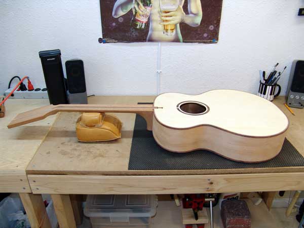

Today we will be fitting a neck to an OLF SJ that I bound in my last tutorial.
Prior to starting to fit the neck it is important to sand with a block the area of the guitar where the neck and guitar meet.  Although a flat area is far easier to fit a neck to I personally never liked the look of guitars with the upper bout flattened.  So I continue the curves and spend a bit more time fitting the neck.  Regardless - true up this area be it curved or flat with a block and sand paper.
Once that is done the neck is trial fitted.

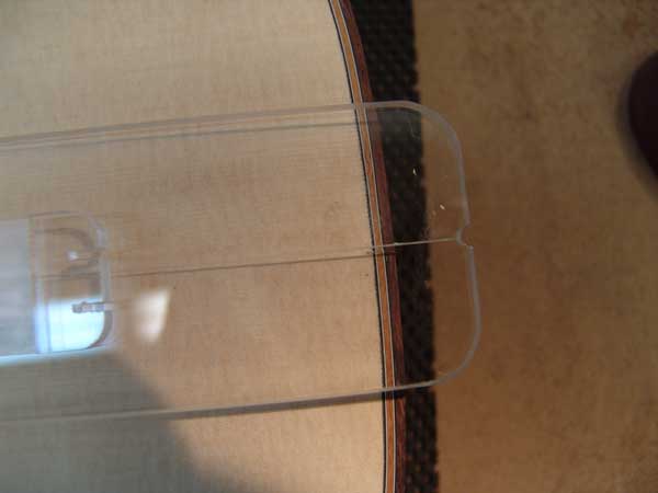

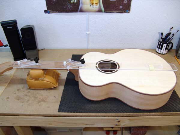

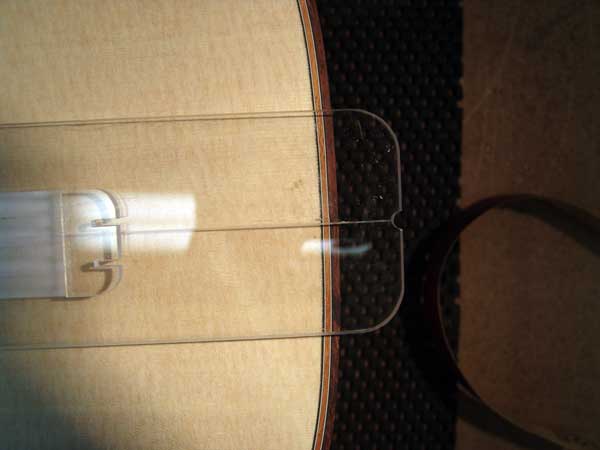

Step one for me is to determine if the neck is centered, left or right, on the guitar when facing the guitar.  For this task I use a neck alignment jig from Tracy at luthier Suppliers, an OLF sponsor.  This is an excellent jig and a major time savor for me.  If you do not have one of Tracy's jigs you can accomplish the same thing with a 36" straight edge.
To use a straight edge simply place tape across the face of the neck in the nut area and at the area where the neck meets the body and make a mark in the exact center of the the two pieces of tape denoting the centerline of the neck.
A third mark is also made on the tail end of the guitar in the exact center of the guitar.  The goal is to align all three marks if using a straight edge or to simply have the alignment jig rest over the mark on the tail if using the jig.
Here is the mark that I made in the exact center of the tail end of the guitar.
The process that I use has three steps:
1)  Align the neck left or right - improve the neck joint
2)  Set the neck angle for the guitar - further improve the joint
3)  Once all angles are correct make a perfect neck joint

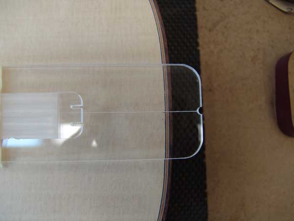

Here is a shot of the Luthier Supplier neck alignment jig that I use.
Here we see the neck trial fitted so we can determine where we have to get busy.

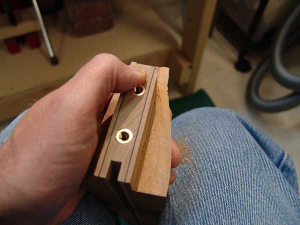

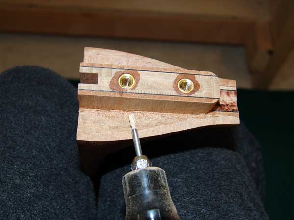

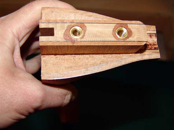

Prior to starting to align the neck and fit the neck the area around the tenon needs to be relieved so that the neck will eventually sit flush on the curved upper bout of the guitar.  Even if your upper bout is flat you will benefit from relieving the excess material around the tenon as you fit the neck.
This is what my neck looked like after I initially relieved the excess material around the tenon.
How you remove this material is completely up to you.  I use a Dremel tool with a bit that I have no idea what it is... and chisels.  Be very careful to not damage the neck on the out side surfaces.....
Please note that when using a Dremel only work in directions where if the tool slips it will not ding the outside of the neck.

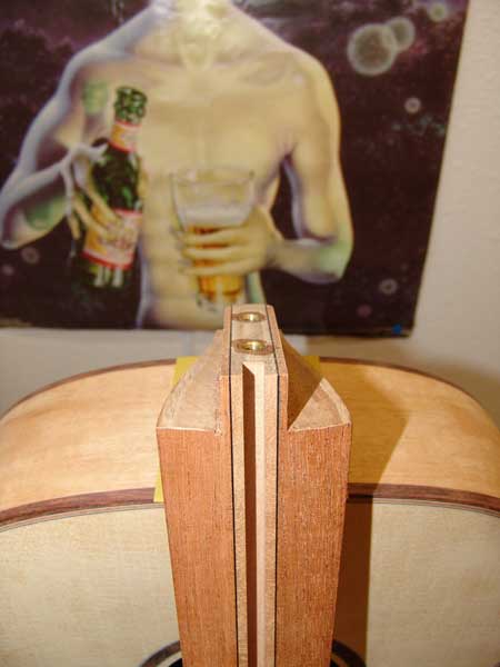

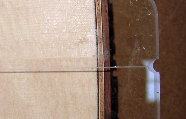

With the neck trial fitted and bolted into place and using the alignment method of your choice check the alignment, left or right, of the neck against the center mark on the tail end of the guitar.
Here we see that my neck is off center by well over 1/4" and leaning to the right when facing the guitar.
This means that I need to remove material to make the neck lean more to the left.  I also place a mark where the alignment jig indicated that the neck was/is initially set at so I can track my progress.

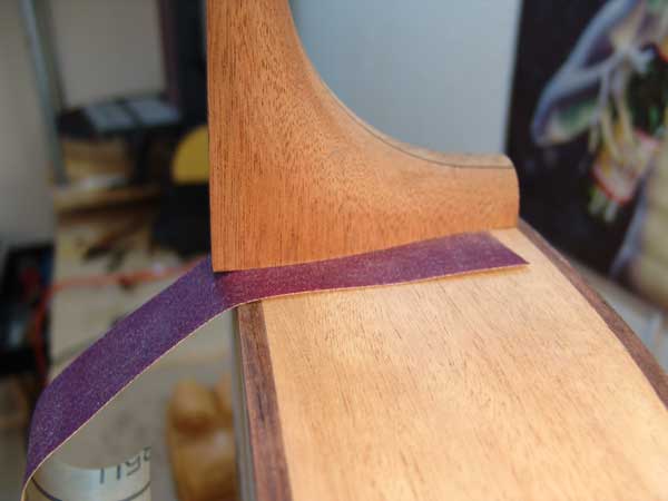

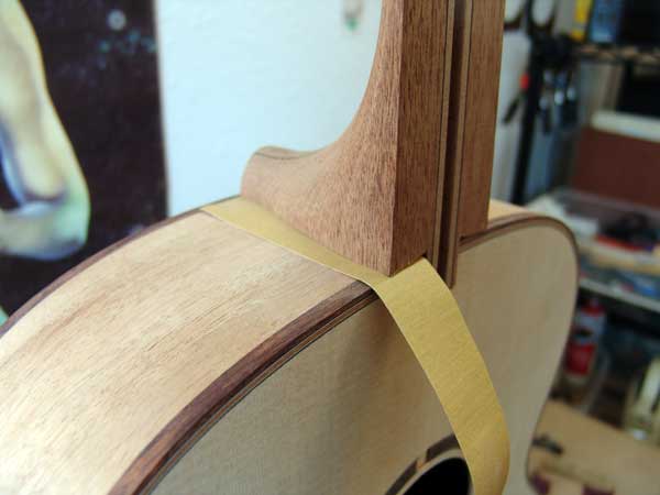

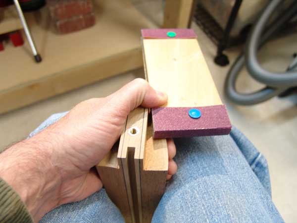

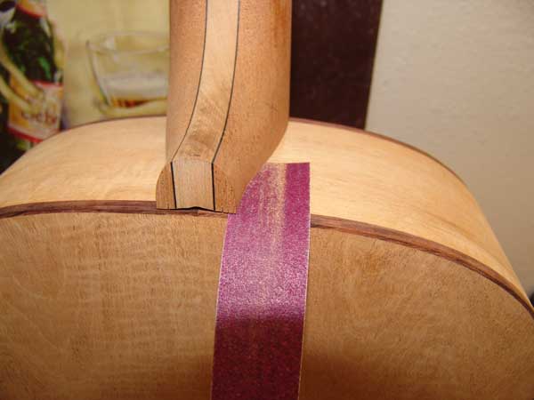

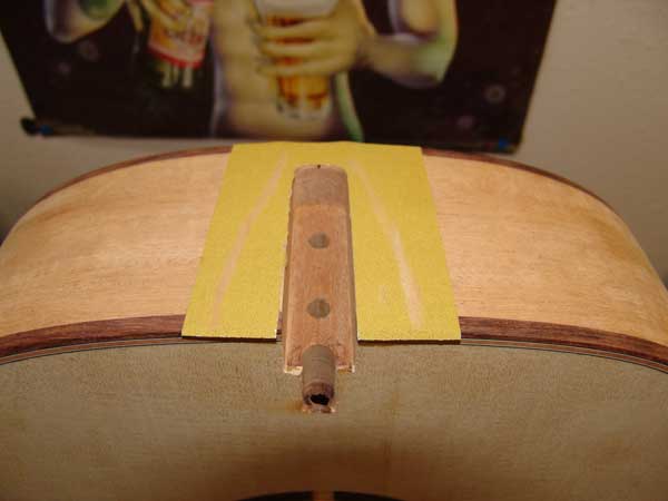

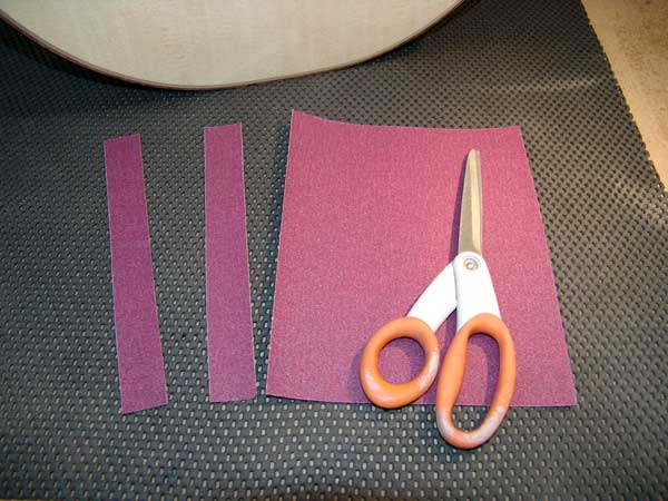

Early on in the fitting process and when major material needs to be removed I use self stick 120 grit sand paper and attach it to the guitar.  The neck is sanded on the sand paper by moving it forward and aft with emphasis/pressure applied to the high side.

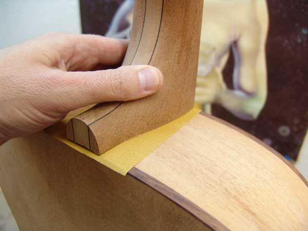

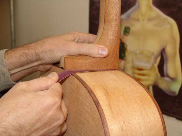

Once the neck is sitting more level and I wish to only sand one side of the neck at a time I will use 1" wide strips of 120 grit and pull them between the guitar and neck.  The grit side is of course up toward the neck since that is what we are attempting to sand here.....  This process is called "flossing the cheeks...."  Really - I didn't make that up......
When flossing your cheeks... what you want to do is pull the sand paper toward you and downward attempting to use an even, full stroke.  It helps to lodge the sand paper strip right up against the tenon and I find that it tends to tear or break less when supported by the side of the tenon.
One hand is of course holding the neck in place since it is not bolted and just sitting on the guitar and the other hand is what you use to pull the sand paper strip with.  Again be sure to pull out and down.  It is very easy to pull out and up and this will create problems for the fit if you do so.
We are attempting to sand down the cheeks on the left side of the neck so that the neck will be more in alignment with the center line of the guitar.
Notice from the sand paper strip the material that we are removing.

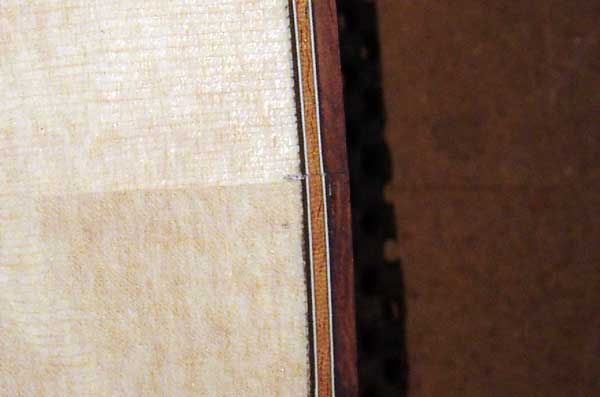

Once the neck has been flossed check the relieved area around the tenon and repeat the step of relieving additional material as required.  What you want to see is a strip of material that contacts the body of the guitar but also retain the relieved area as well so as to not have this area interfere with seating the neck.
Next, and before further reducing the left side of the neck we check our alignment once again.
Here we can see that we have indeed moved the neck alignment more toward center and it is close enough, for now, to move on to the neck step.  Remember that step one is centering the neck, left to right, and improving the neck to body joint.

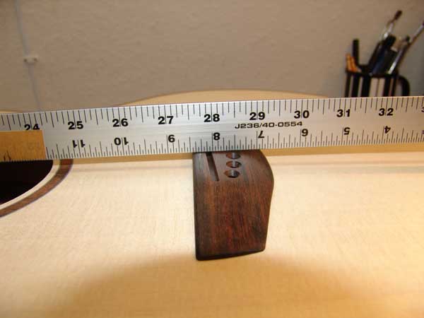

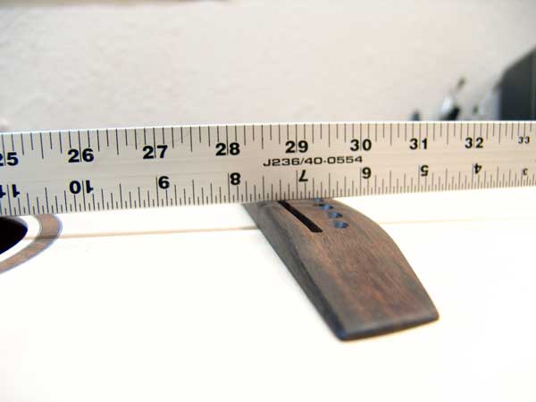

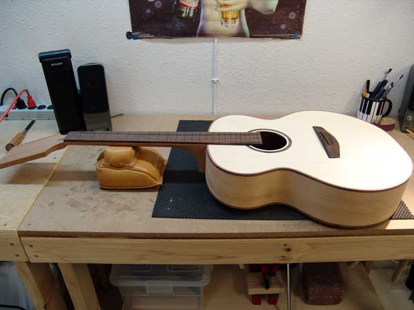

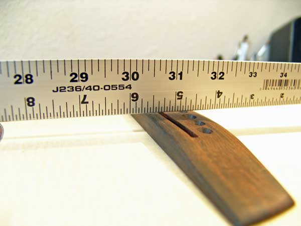

OK step two is very critical and it is setting the proper neck angle.  Although various builders use different specs for this I like to set the neck angle so that with the fret board on the neck and the bridge properly located a straight edge will skim the top of the bridge and be about 1/32" above the bridge.  The straight edge is pressed firmly on the fretboard and any bow of the fret board is pressed flat as well.
Here we see the BRW fret board and bridge located where they will live.
Although it is difficult to see from this picture the straight edge is sitting to high above the bridge.  This means that the neck is leaning to far back and the neck angle must be improved.
Please note that I like to do the neck fitting prior to attaching the fret board.  Every thing is easier to get at and work with and you can also floss from the front of the guitar this way.  Although we will endeavor for a perfect fit of the joint and a perfect neck angle and neck alignment now once the fret board is attached things will be rechecked and if any minor adjustments are required they remain just that - minor.
Since the neck is leaning slightly to far back this means that we need to remove material from the front area of the neck cheeks.  I do this with a block and sand paper and try to sneak up on it rather then risk taking off to much material with a chisel or any other method.
With the block I try to just sand the front areas of both cheeks also counting my strokes in an attempt to preserve the previously gained left/ right neck alignment.
You can also reinstall the self stick sand paper and sand the neck on the body taking care to only sand the front of the neck cheeks.
After the front of the neck cheeks have been sanded the neck is bolted in place again and the left/right alignment and the neck angle are again checked.
Here we see that the neck angle has been improved, the straight edge sits closer to the top of the bridge.

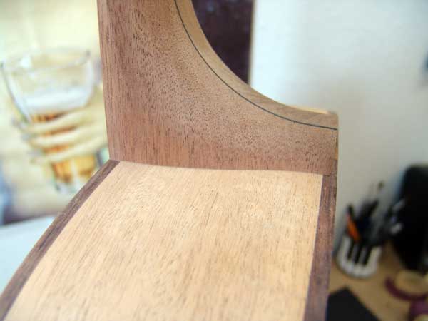

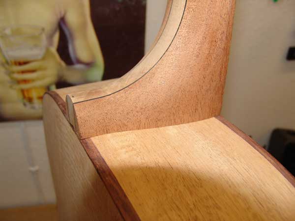

Now with the neck angle getting close, the left/right alignment very close as well, it's time to go at the neck joint while keeping in mind any improvements that we need to still make to the neck angle and alignment.  In this case some additional material will need to come off the front of the neck cheeks and the near centered neck alignment simply needs to be preserved.

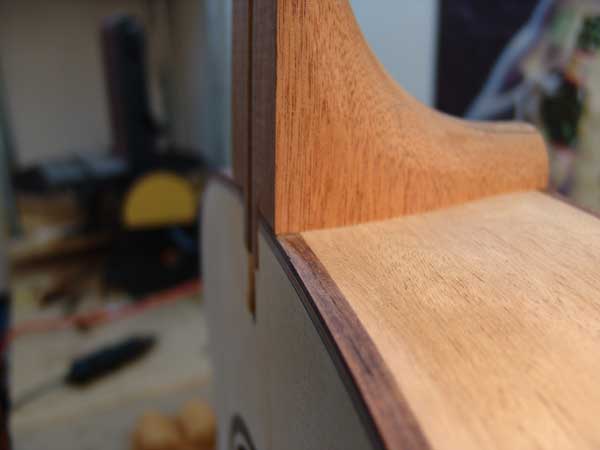

I move on to flossing again taking care to attempt to "read the joint."  What I mean by reading the joint is that the neck joint will tell you where it has high spots and where the gaps are.  With a little practice you will learn that you can only insert the sand paper strips part way into the joint and only concentrate on problem areas if you wish.  You also have the option of working from either the back or the front of the guitar again isolating problem areas.
Since we are trying to preserve the alignment that we worked on earlier be sure to count your strokes and repeat the exact number of times on both sides.

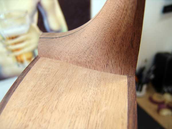

Here if you look closely you will see the the front most edge of the neck has a slight gap between the guitar's binding.  Now that you have "read" the joint you can elect to place the neck so that it over hangs the body over the binding so that when you floss you are no longer creating a gap here.
Once my neck joint is gapless I again recheck the left/right alignment and the neck angle and if they are perfect I move on to flossing on both sides with 220 grit.
Once I am satisfied that my joint is perfect I again recheck the alignment and neck angle.
Here we see that the alignment is perfect.  Remember that you can manipulate the left or right alignment simply by flossing more on the high side.
And the neck angle is rechecked once again as well.  The straight edge now comes in over the properly located bridge 1/32" above the bridge.
And the results, a very nice neck joint - here is the left side.
And the right side.

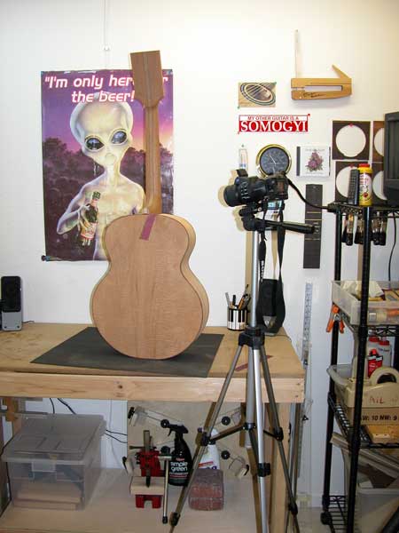

As an added bonus I was asked by 3 members how I photograph these tutorials where sometimes it seems difficult to be holding a camera.  Most of my camera work is by hand but for some shots I set up as below.
I have a very well lit shop with various spots that I can direct where I want them.  Photographing what I am doing is great fun for me and only takes seconds to do most of the time.  I just replaced all my florescent bulbs last week because these lights tend to lose half the lumen output in one years time.
And of course I use a timer when I can't sling the camera.
