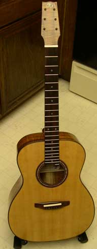

Hey Everyone,
I picked up some inexpensive Engleman tops off of ebay to try and perfect my skills. I joined and sanded one, and was surprised at how different it looked compared to the higher grade tops I had been using. It seems to have decent stiffness accross the grain, and it is pretty close to quartered. But the color variation is sure pronounced.
Do you think it is worth using? I could always make braces and bridge patches out of it, or practice making rosette channels.
Jeff

Jeff..
I actually *LIKE* my tops to have some color and striping, I choose them based on that (along with other things).
If it's got good tap tone I would use it, I built this one out a piece of Spruce top I found at a wood store (read not a normal place to find tops) in the bay area and it ROCKS!!
In fact the top looks better because of the striping IMHO
Use it, take your time doing the rosette and you'll have a great guitar.

I like it too.
Nobody paints sunburst acoustic guitars anymore. I always thought they were neat.

Jeff,
I don't get why pronounced color variation is a desired feature in backs and sides, but undesirable in tops. Peronsally, I love the look of striped spruce, and the stuff you bought looks great to me. I have never heard anyone suggest it adversely affects tone, either. So I suppose the only downside is that the guitar-buying public has been brainwashed into believing that color variation is a sign of inferior wood. As long as the guitar is either for you or for a customer who hasn't been brainwashed, though, I would vote to use it.

That's a perfectly lovely piece of spruce. If it's nice and stiff, taps well, by all means use it! My absolute favourite tops, visually, are the FA redwood ones I got from Hank Mauel, closely followed by some fairly stripey WRC. I mean, there's also a particularly simple kind of beauty to even-grained, well quartered, silky spruce, but a little bit of striping and colour variation adds plenty of character.

You seem to have a unanimous response to this one, I would certainly use it and it will probably end up a much nicer more interesting top than a plain white looking one. Don't overdo the rosette or it could end up looking too busy. After all your building a musical instrument, when it comes to the crunch if it sounds good that's what matters.

It looks incredably white to me. In fact I could not tell the difference between the top and the background. Is there any grain at all?
(actually I don't believe either picture loaded)

I like to see some grain in my tops. I say use it.
If a customer come by and orders one with a pure white top you can always order one then.

maybe I missed it but how cheap is cheap? If you didn't pay too much than maybe you could consider some other use. Perhaps you could position it so that the sound hole is located where that swervy part is? or perhaps the bridge, if you use it for a smaller model. I like grain and color. I don't like swerve/curve ( in a guitar top that is)

I would use it, if it is stiff enough. Flex it and see what you think, if it seems a little floppy, leave it a little thicker than normal and use good stiff brace wood.

Nothing wrong with that top! Man, if you ever start using red spruce, you'll be discourgaed to no end <g>
Once the thing is built, is bound, has a rosette and a big old soundhole in it, add some finish, maybe some toner, or give it a year to start turning gold, and that coloring all but dissapears.
If that is too ugly to use, 80% of what I build would be too ugly to sell.
By the way, if you candle it, you'll likely see that the darker streaks are denswer than the lighter ones. There's an advantage to that....

While I would probably prefer a dead white top, I try not to judge soundbards aesthetically when selecting them. The main purpose of a soundboard is deeper than looking pretty, and I think the one in the pictures you gave would look just fine. I wouldn't have any reservations in using it (except for I like European spruce)

Just use it! I like stripes and colors in my tops. Since you are still learning the craft like me, it will probably be your own guitar, so what the heck.tl50736238435.519837963

I have 3 guitars nearing completion. One has a rather wide grained Red Spruce top with some color variation in it, and another has a pure white Engleman higher grade top. I actually prefer the looks of the Red to the Engleman.

The way the color varies between the two sides suggests a lot of runout. Not that you shouldn't use it.

Yes, there is some visible runout in the sapwood, but it doesn't seem to carry far into the piece.
Depending on how it looks in person(pin knots, pitch pockets, etc...), I'd consider joining the other edges; they look cleaner from the photos...

Cut a four inch hole.
Throw three sets of rings on it.
Slap on a bridge.
Peel and stick a pickguard.
Add the fingerboard.
Install Binding and Purfling.
What you have left is a pretty good looking top.
Not perfect, but then we don't require our clients be perfect either, now do we?
Oughta make a great guitar.
I agree with Mario, red spruce can be a bear.
I'm doing a dread right now and it is quite the ugly duckling top.
That said, with all red spruce adirondack bracing this guitar will really sing.
Use it.

I say use it, white tops are ok, but not at the expense of punch and sustain. I like red spruce anyway and at this point almost get suspicious when I see a builder whos tops are always white.....makes me wonder if sound is his/her first objective.
