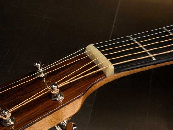

Okay, this is an achilles heel to me and I'd like to solve the problem of perfectly installed nuts.
1. Getting them to fit nicely on three sides is difficult. I want it to be visually pleasing, in other words, perfect.
2. I have no problem topside with string action, or shape, polish.
3. Just yesterday, unhappy with the fit I removed a nut. The raw mahogany peeled out fibers and they were glued to the bone nut. Ouch. So, apparently nut slots should be sealed with finish to seperate it from the nut material easier?
4. I've thought of setting up a router to slice a perfect slot which I've done on an electric bass before, but not on an acoustic. Then there is the problem with blowout on the exit of the slot.
Well, as you can see this is a thorny issue for me and by golly I need to draw on some experience you guys already have. Pics are nice if you have any. Thanks, back this evening to check the thread.

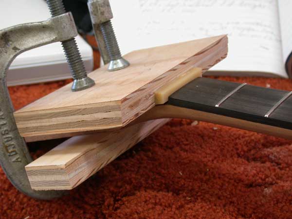

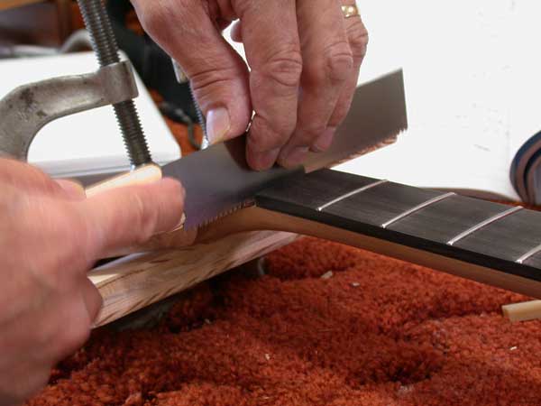

Here's what I do.
I start with a rough nut, sized on its fitting surfaces, bevelled on the bottom, not shaped on top nor cut to length. The bottom of the nut is bevelled on the disk part of the disk/belt sander, with the table at the desired bevel. A plywood guide is bevelled on the edge using the same table setup as for the nut. The nut and guide now have identical bevels to match the headstock angle. The nut is placed against the end of the fretboard as a spacer, then the guide is clamped very snug up against the nut, like this.
Remove the nut. I now have the guide's bevelled face coplanar with the tuner side of the nut. Using a small Japanese saw, or X-Acto saw, cut the end of the headstock overlay while pushing the saw up flat against the guide. Stop just shy of the neck wood.

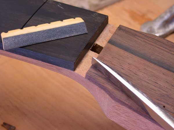

Break out the cutoff of the headstock and clean out the slot with a narrow chisel. Sometimes
I use an old nut with a piece of sandpaper glued to it.
We now have a slot sized to the rough nut.
Shape and finish the top portion of the nut. This one still needs some material taken off the height.

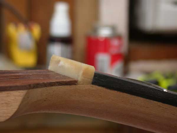

Bruce...Here's the sequence I use.
Glue the FB to the neck.
I usually seat my nut on the angled headstock. That requires that I have the north and south sides of the nut parallel to each other.
The bottom is angled at 15* by sanding on the disk sander with the fence angled to 15*. It then seats perfectly to the angled surface on the headstock. Keep tweaking until the south side of the nut butts up perfectly to the FB.
The headplate edge is angled at 15* such that it fits perfectly to the north side of the seated nut. I use a tablesaw to make the cut. Once all those angles are established, I glue the headstock such that all 3 sides are perfectly seated.
On the bottom side of the nut I only put 2 very small dots of the weakest glue I have. No need to adhere the nut to the neck so tenaciously. It should release with a smart tap from a wooden block. In some cases, I have forgotten the glue and it seats well enough without any problems.

 I'll add that for glue, two drops of super glue, drops, tiny drops, on the fretboard side of the nut, is all it takes. None on the mahogany part, please ad thank you <g>. The nut doesn't need to be glued solidly, only held in place when the strings are off.
A string nut is something that WILL need replacing in the guitar's life. Make it easy and safe to remove.

Nice Tutorial Pat. Thanks everyone for your input. This isn't rocket science, but I can see you guys put a lot of thought into your methodology.
Pat the sandpaper on an old nut was really cool. I was trying to drag some sandpaper under my nut, but it didn't work too well. Good tip.

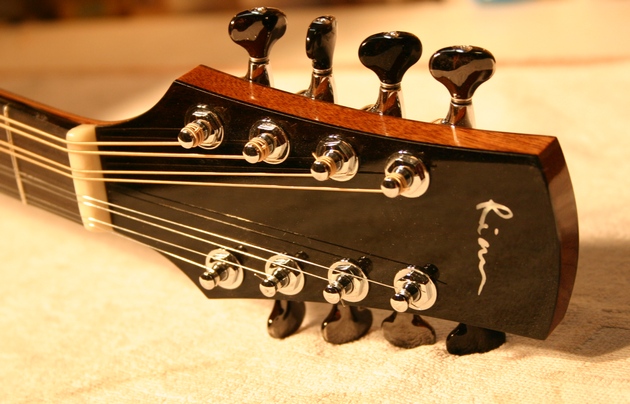

Rian, that's a beautiful bouzouki nut and finish job. I just enjoyed it again this evening. My nephew was over and I showed him Andreas Aase playing it on You Tube.
