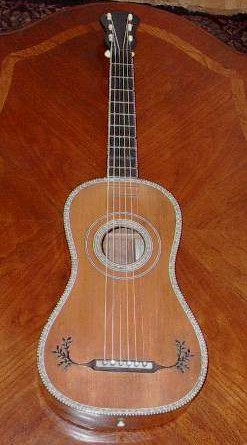

John, my 1700 Strad is only just off the drawing board so nothing much to see at the moment. I've got a couple of months of rose carving to do first! I'll put some pics up when that's done. The 'strad' will be 5 course (10 string) gut strung. This is a guitar from a slightly later period with the 'moustache' The strad will be a bit fancier! I'm really getting into building the early instruments and the more you study them the more you realise that there is little new.
1780 Guitar (anon)

That is an impressive moustache. I assume the strad has a carved rose in the soundhole, are the back and sides made of strips of wood or are they more or less single pieces like modern guitars?

John, yes the soundhole does have a rose but not carved out of the solid spruce top as with the lutes, this rose will consist of three layers of pierced fruitwood. The back is much the same as the modern guitar two main pieces, bookmatched with a centre strip (I told you there was nothing new).
