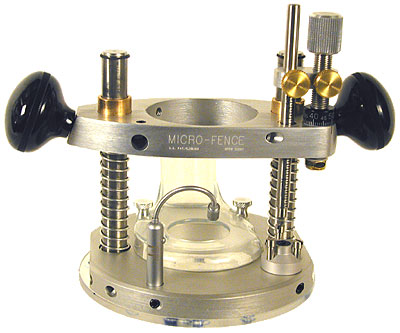

Micro Fence is making a plunge base similar to the Cochran that fits the Colt and others. Just as pricey too.
PostPosted: Thu Aug 02, 2007 7:09 am
i first became aware of the microfence base about a year ago. it is very, very nice and so it should be since it is about 50% dearer than the cochran base, and that is without a fence/circle guide which is standard with the cochran base. i think the microfence is another $150+= dollars on top of the base. basically you're up for about $500 before you put a motor in it.
but it does have a nice worklight and presets.
another problem with it is that due to the base having a solid base without the cutout featured on the cochran bases, to cut small circles you have to get still another attachment.
i took a look at it then and decided it was a bit too rich for my wallet.
