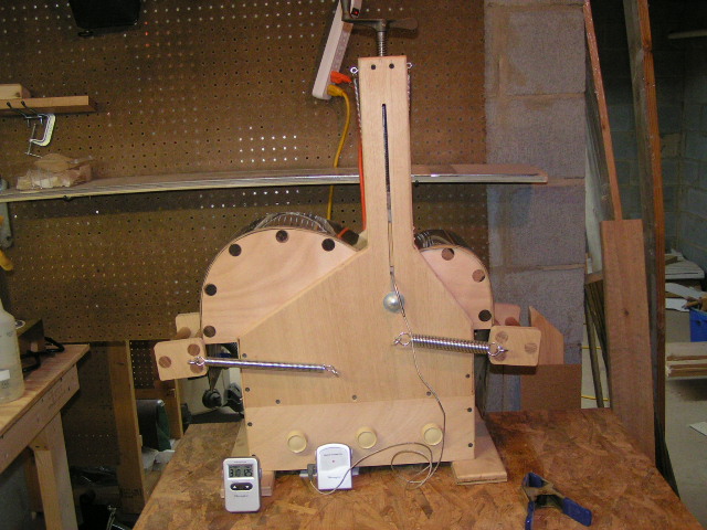

I built a bender a while back with bulbs only (no dimmers) & it's worked well for me. Basically, I just reverse-engineered pics from LMI & various websites (turbocadd helps)
Bulbs are 150w (I change the upper to 200w on cutaways) & rams are 5/8" x 10tpi threaded rod. Probably cost $60 total
My sequence is paint/wipe off with distilled water (both sides), wrap in tinfoil & position between pre-heating slats. After contact, advance waist ram 1 turn per minute 'till bottomed, then do bouts. Cutaway is the same (over the "hump", then 1 turn per minute 'till done). (I think this is the secret- advance is so gradual that the wood yeilds without protest.) Lights immediately off, cool 2-3hrs, recook 10 min., cool overnight. I thin my sides to 075" (.065 in the tight bits)
While blankets are I'm sure very nice, my limited experience tells me if your doing non-cutaway guitars, you should have no problem with bulbs. I've done 4 sets, all cutaways- all curly maple (not the easiest) without mishap. (...couldn't say that about the hotpipe!!).

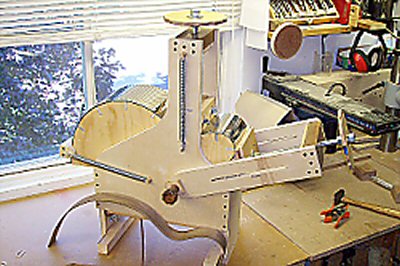

This guy explaion how he did his.
It is in German, but the pictures are English
Was helpfull to me.
Fox Bender built

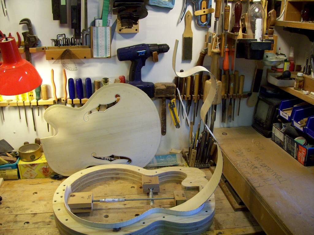

Further to my post above, here's a side I took out of the bender this morning. It's a new design for me & I was a bit worried because of the tight cutaway (1" R) and horn (about 1 1/4"). It came out great- no scorching (even with 55 min. start to finish time) cracks or blemishes.
Dave
Milton, ON
