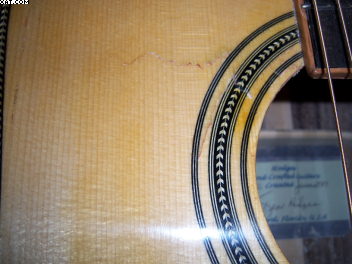

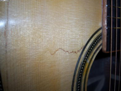

I'm waiting on some parts to arrive, so I thought I would work on the cracked guitar.....
remember this one?
well, I tried to get clamps on everything and glue it back together but it sticks out like a bad toupe with a chin strap.
I did string it up and give it a whirl though... it sounds really good except for a buzz on the G string. I cant find any frets that it is touching, so I am assuming that it is a resonance point for the crack.
It is going to get a new top anyway, but I just wanted to hear it... Now for some fireworks for tonight
PostPosted: Wed Jul 04, 2007 5:36 am
Open G sting ??? if so the nut slot is flared at the FB end, and thats where the buzz is.

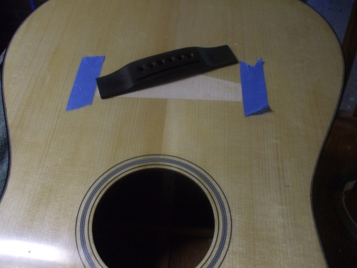

Since its so hot right now (100+) and my basement is cool, its bridge gluing today and picnic later on.

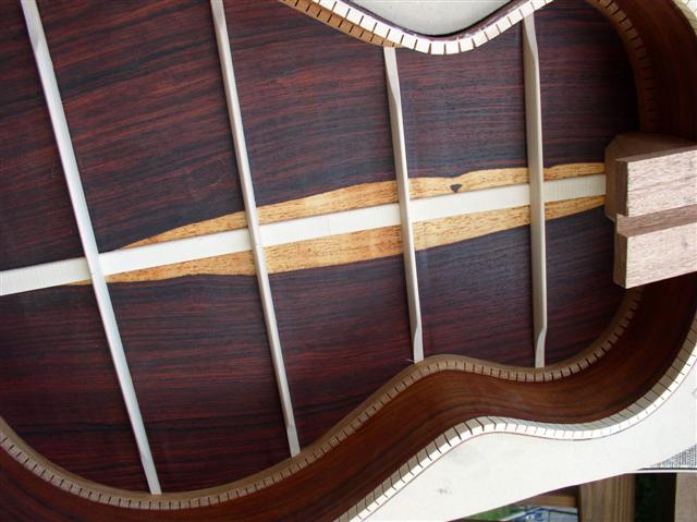

I closed the box on my cocobolo SJ today. Yay! Now it's starting to look like a real guitar! Now, I just have to build my binding routing fixture once the aluminum plate arrives, but that'll be this weekend. I'm getting excited now about finishing it. Let's hope for a break in the summer humidity in about three weeks or so...

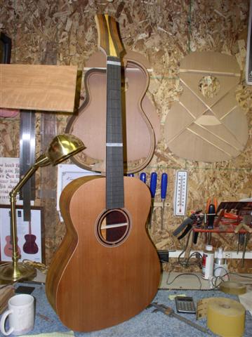

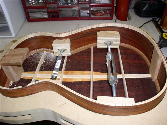

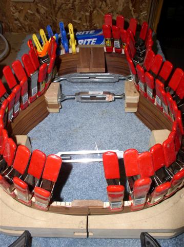

Starting yesterday evening I braced and voiced the top to this box and today I closed it up,
Blocked and added the top linings to this set of rims,

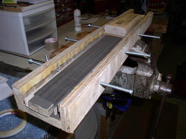

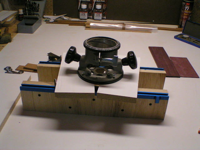

Slotted, bound and radiused this fretboard,
Played catch with Theresa, and watered her flowers

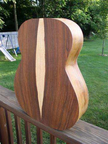

While I was out there I snaped a few shots of a coco box before and after closeing it up.
I am trying to have this one ready for Tony a week from this Saturday when I go to pick up the little 0-12.

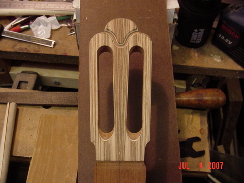

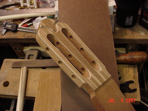

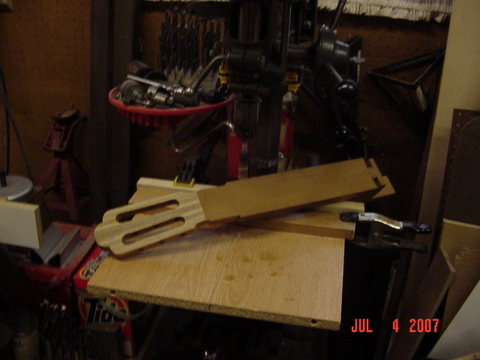

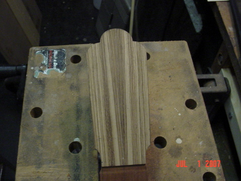

It was only about 85 in my shop today.  I considered it a good day.  Humidity is controlled.  So I worked on my Headstock.  I had a glue failure on the backplate of the headstock, and had to remove and replace the wood.  I did that and shaped the rough outline last weekend, so I started today from this.

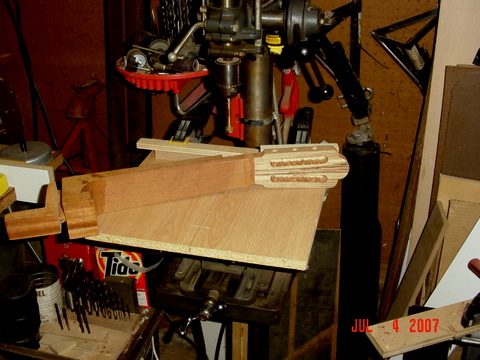

I drilled the tuning key holes using a guide block from Specialty Tuners.  Then I used carpet tape and taped a piece of wood to the face of the headstock to control blowout, and used a forstner bit to rough out the slots.  Ended up with this:
Sanded out the inside with a 1/2" drum sander to this. (Not a good picture.
Then I used a template I made, and routed with a llittle v grove bit to get this.  It is not completely right yet, but this is as far as I got.

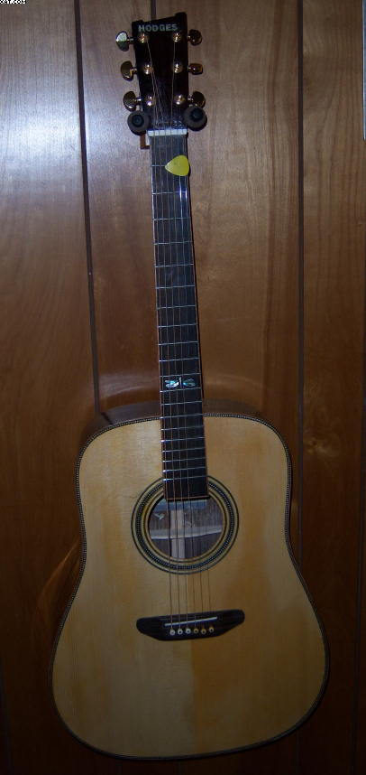

Finished binding my current build--EIR bindings with herringbone purf--got most of it scraped today--star the neck fitting and final sanding this weekend. Won't be long till this ones strung up.

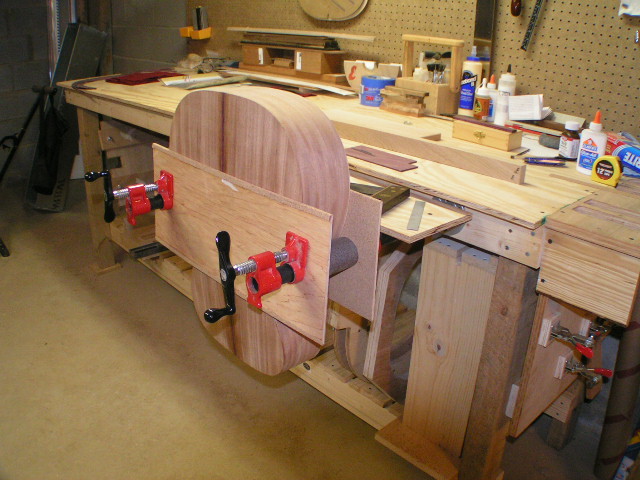

I did still Bill's body clamp idea......
and I've been working on a end graft jig......
It sure is nice and cool down here in the basement......

Lance
How does that fret board radius jig setup work??? Trying to understand the logic.
I use a similar radius block but just double stick tape the fretboard to the bench and then have at it with the block. Am I missing something?
