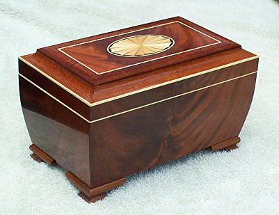

For my money, nothing captures the richness of mahogany (think 18th century museum pieces) like the traditional chemical treatment of dilute potassium dichromate solution. I've used it on reproduction furniture for years (typically under FP). This jewellry box gives you some idea.
It is not a stain so it doesn't mask anything. (looks like orange Koolaid & reacts with the tannins in the wood to bring classic red/brown). Water based, doesn't blotch, easy to use/adjust, POISON!!!!

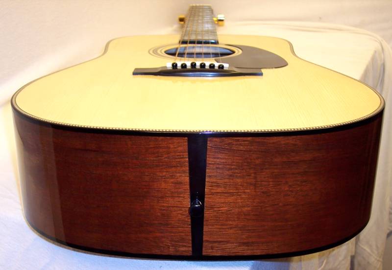

I also used the Colortone concentrate liquid stain.  I stained, wash coated, pore filled, then sprayed.  It worked well.  If I remember correctly, I mixed 75 drops mahogany, 50 drops tobacco brown to 1 oz water. That mixture of mahogany red and tobacco brown got me this coloring on a mahogany d****n*****:

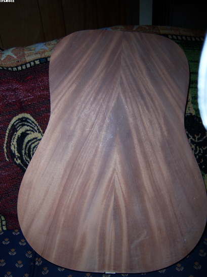

I happened to have an old solution of Potassium Dichromate handy, so I dipped a sliver of sapele and a piece of mahogany into it and let them dry on a scrap of curly maple. After they dried, I wet with ethanol to see how they might look under finish. The top piece is sapele and it certainly darkens quite a bit with the potassium dichromate, much like the mahogany below. You can see what it does to the maple as well.
Others' warnings are justified. In powdered form it is extraordinarily toxic if you breathe it so at a minimum use a respirator when making a solution and gloves when working with said solution.

The picture above really doesn't do justice to the effect of P-D on striped Sapele (good experiment, though!). P-D gives it a three-dimensional shimmer and richness that's quite beautiful. That being said, I'd try something else if you're not solidly set up with proper ventilation, heavy gloves, chemical-proof goggles and a cartridge respirator. Then there's the issue of disposal....

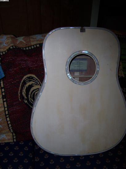

By the way, here is what I am working on... I only have one side of the bling in right now, so I am still working on it... You can see the figure to the wood though
