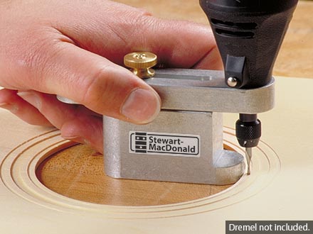

Somthing like this should do the trick

Ya, the great thing about that tool is the unobstructed view.
Nice one Michael!

Michael,
I considered that tool but my ovals are really small. I said about 2"x 3" earlier but they are more like 1-1/2x2-1/2. The Stewmac jig wont fit. If there was one with about a 1" base on it, it might work but it might be too tippy.

PostPosted: Wed Jun 27, 2007 8:47 am
make your own that will fit from rock maple

[QUOTE=MichaelP] make your own that will fit from rock maple [/QUOTE]
Worth considering. What are the thread specs on a dremel? I recall that they are somewhat unusual.
