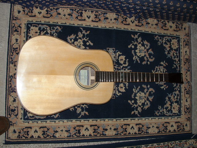

I am almost finished with the latest build, and had a good finish on it, had set the neck on Saturday night and then pulled it out of the clamps this morning. Man was I proud of the way it looked and it just wanted to ring even before I had any strings on it.
This is a EIR back/sides, Sitka top, Mahogany neck and has herringbone purfles and rosette. The Binding is oak, from an oak tree I cut down and milled into lumber about 2 years ago.

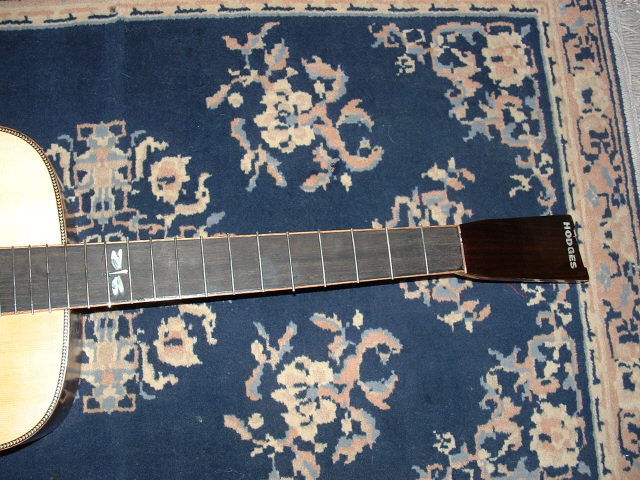

All was well until I started setting the frets. I had them all set in place...
Had a little trouble with the 13th fret due to some CA being in the fret slot, but got that cleaned out and proceeded to tap the rest of them in. All looked good except the last fret, which was slightly up and aparently didnt get set completely, so without thinking about using the steel caul I gave it just one more tap to set that last little piece in place.

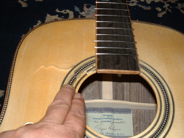

Then I heard this strange sound.....
I didnt see anything wrong at first, but when I set the guitar down I could see what appeared to be a crack in the finish....
It wasnt a crack in the finish....
I'm not prone to outbursts of expletive language or panic attacks, but this one was over the top.... or was about the top anyway.
Looks like I am going to have some experience in removing dove tailed necks, fingerboards and tops.

You hit the proverbial nail on the head with your statement "so without thinking about using the steel caul I gave it just one more tap". Lesson learned - never hammer frets into an unsupported neck or fingerboard extension. This top should be framed and hung on your wall for future reminders.

Oouch! Sorry to see that. Better this happened now then ten days after you sold it. From the looks of that crack, it might have happened anyway just stringing it up.

After reviewing your pictures and the way the top is cracked I am inclined to believe the top failed due to excessive run out. It can be seen at the center joint and is quite prominent. The way the top cracked, cross grain, and at what seems like a 45*-ish angle through the wood almost leads me to believe the wood had an internal flaw combined with excessive (and even quite possibly localized) run out. In my mind the wood should have cracked along the grain and not across the grain. This is a strange failure for just a light tap with a fretting hammer.

I think Tim is right. It sure looks like it could have been an area of runout the way that broke.

[QUOTE=Tim McKnight] After reviewing your pictures and the way the top is cracked I am inclined to believe the top failed due to excessive run out. It can be seen at the center joint and is quite prominent. [/QUOTE]
I agree with Tim.
The big color/reflectivity change between the top halves points to the runout, which was revealed dramatically when you gave the top a 'shock'.
In a way, you're lucky you found this flaw in the top before the guitar got into the customer's hands.... just repeat that enough times and you may start to believe it! I do share your pain (as the famous say).
I'd have a good look at the rest of the tops from that lot as well.

Since it is not an open split along grain, and if there is no offset on the rosette and the crack stops at the fingerboard, and with the easy accessed near the sound hole, maybe it's possible to glue it back with hide glue, spot sand, and refinished.
