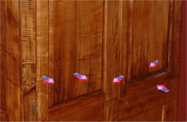

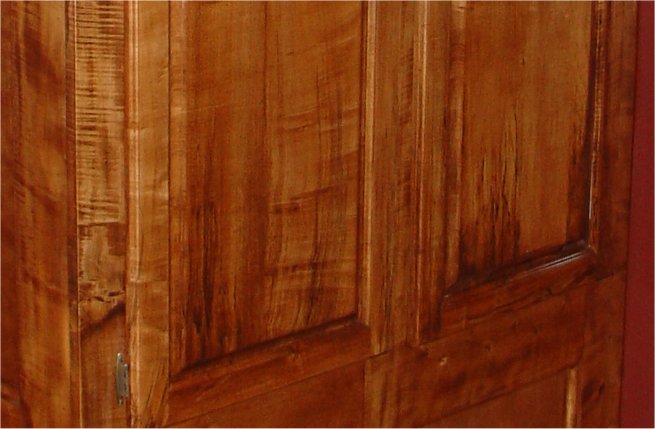

Here is a shot of some doors. You can see the spalting streaking up from the bottoms. All of the photos I have found so far have just the stained spalting. I'll try to find some before and afters of other spalted moldings and post them.

[QUOTE=Chris Oliver] Here is a shot of some doors. You can see the spalting streaking up from the bottoms. All of the photos I have found so far have just the stained spalting. I'll try to find some before and afters of other spalted moldings and post them.chris
I see lots of curl and crotch in this photo. I must be missing it but I do not see spalt.
PostPosted: Tue Jun 26, 2007 12:52 am
Posts: 567
There is a bunch. The stain really hides the gray and black. That is why I wish I had a before stain photo of these doors.

PostPosted: Tue Jun 26, 2007 12:57 am
got ya!
