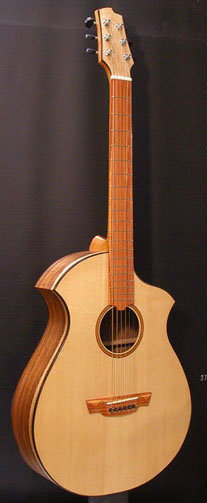

I'm just curious if anybody has tried one of the new acoustic guitars by Ken Parker? On his guitars, he pushes the waist forward creating a bigger lower bout. They look interesting and I'd really like to hear what moving the waist so far up sounds like.

I haven’t actually played one of that modal but I did build something that closely resembles one. I might add that I designed and built this guitar before I knew about Parker guitars.
It has the larger lower bout but also is a 13 fret to body, placing the bridge a bit closer to center. The overall sound is punchy, emphasizing a mid-range voice.
It’s my favorite one to play, so far.
