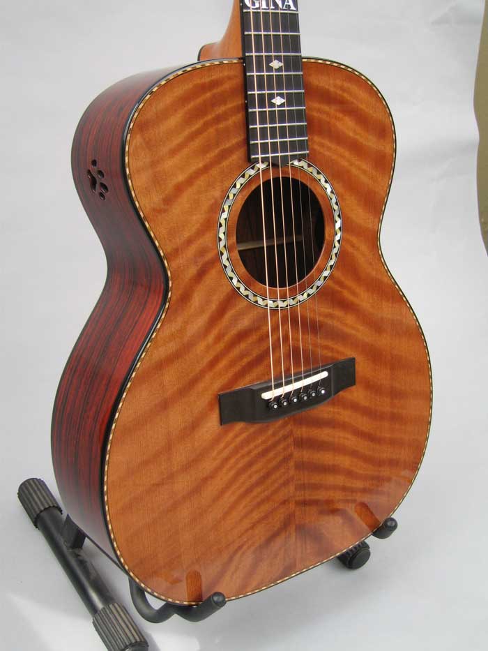

Here is my most recent redwood top. I thicknessed it to 0.113. based on deflection testing. Keep in mind, my tops are generally thinner than most tops
