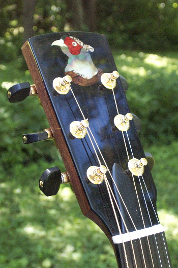

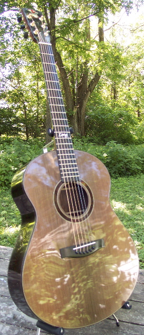

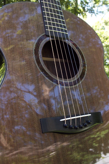

I just finished this for a guitarist who is also an avid hunter. He wanted a guitar that was not too flashy. (so I had to restrain myself) We went with a IRW/Sinker Redwood combo for a dark, understated look. And a Ringneck Pheasant for an inlay.
It's only just recently strung-up, but so far, it sounds very balanced, but with a big bass, (I think it will sound really good in lowered tunings).
The Ebony came from RC Tonewoods, Thanks Bob!
Binding is off-cuts from the sides.
Rosette is off-cuts from back.
Neck is Walnut/Bocote/Walnut/Bocote/Walnut.
Oh... I'm not showing photos of the back... I don't want the owner to see it yet... I gotta' have something to surprise him with
Thanks for looking

Did you do the same thing with top thickness and bracing as you did with the guitar you had at ASIA ?
Bye the way, I saw that guitar being carried through the airport on its way to its new home in Canada!!
Mark
PostPosted: Wed Jun 20, 2007 6:56 am
Posts: 588
Thanks everyone!
Dave, the guitars owner is going to have it shot by a real photographer, so I hope to have some really good pics of this guitar (including the back).
Mark, this Redwood top was only .120 - .125 when I got it, so I had to approach this one a little different, it finished at about .110 and I used Sitka braces instead of Cedar. It's scalloped X bracing with two angled tone bars.

Real cool Long!  What do you use for red in your headstock inlay? Rich

Very cool ringneck pheasant inlay Bob! I used to hunt them back when I was growing up in Ohio.Very tasty. Great looking guitar overall!

Rich, the red in the inlay is bloodwood.

Beautiful work Bob. You must have been working on a couple at once because I've seen you post some sweet looking guitars over the last few weeks. I do have a question for you. You mentioned that because this was a thin top you used sitka instead of cedar bracewood, why would you normally have used cedar for your braces? I've only worked with sitka tops and braces, so any info on material selection would be appreciated.

I don't really use cedar or spruce bracing for any particular top. (Yet) But I have been switching between the two in an effort to develop a sense for what the difference might be. I've done deflection test between the two and they seem to be pretty close to the same.
So far the only thing that I can say with certainty is the cedar bracing makes the guitars smell nice.
The guitar Mark mentioned had a Lutz top that finished around .145 and it sounded really good, I've been going more in that direction... thicker tops and lighter braces. I think this keeps the tops from getting some of the deformation you see in tops that are thiner.
