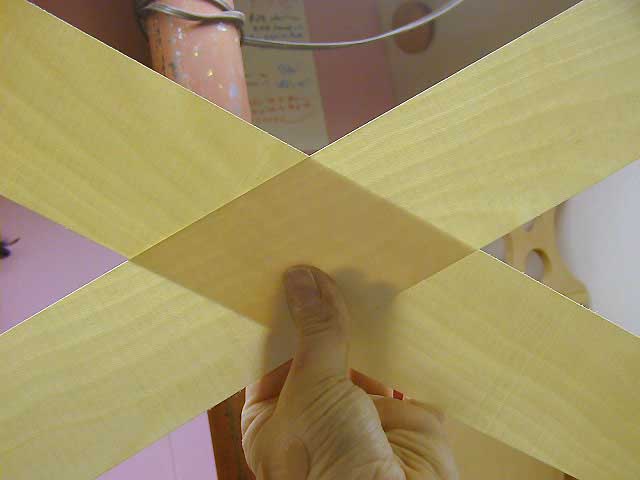

Finally tried out the 1/2" WoodSlicer on my Grizzly 18". WOW! That is the nicest running, vibration free, weld problem free blade I've ever seen. I used it over the weekend to cut some veneers (0.018" and 0.029" rough size) for purfling lines. The stock was 4" wide and 36" long. Over the whole cut, the variation is about 0.002"-0.003"! That's in the form of very slight saw marks. Photo below with backlight showing through the veneers.

Wow! Pete that is impressive! What kind of wood is that?

Congratulations Pete. There is nothing more fun than resawing success. I'm totally impressed with your results. Not only does it speak highly of the Woodslicer, it highlights the quality of the saw... and expert setup by the operator!

Bruce - Let's just let it speak highly of the operator's setup! ;-) The saw, and all it took to get it running well, is not the highest quality.
Jeff - Aspen from Home Shallow. I use that as a wood for lines when a wood whiter than maple is required. I find that especially the thin maple lines (0.012/0.3mm) sometimes seem to "disappear" especially if installing with CA.
