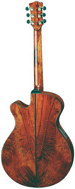

PostPosted: Thu Mar 17, 2005 4:52 pm
Paul, the descriotion you give of that Tasmanian Myrtle doesn't sound much different than our Oregon Myrtle. Can be had with nice figure, is stable and bends pretty easy. It make a very nice guitar. Oh, Here's one now.
PostPosted: Thu Mar 17, 2005 9:02 pm
Tasmanian Myrtle is actually a species of beech, or so I understand. It looks similar to the guitar in the pic above but is more redish brown, I expect that it works about the same. Here's a pic of a mandolin that I've just come across that has a Tassy myrtle back. I've seen pics of tassy myrtle that are a much more vivid red/brown though.
