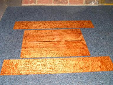

Ok fella's, I need any kinda help you can offer.
I have a wonderful set of Quilted Mahogany I got from Brian Hawkins, Beach Tonewood
Very simular to this one which Brian donated for the OLF auctions a few weeks ago.
I'm going to be using this for a personal guitar I plan to use in church. This guitar will have a Venetian Cutaway, what would you recommend for thickness at the cutaway area, and what bending temp would you use? Also, how much water?
