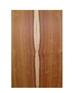

Oh here's what it looks like at 90K. Hope it posts...

Grenadillo before I joined the back.

Palo Escrito back before joining
PostPosted: Wed Mar 16, 2005 2:15 pm
Posts: 1584
Location: PA, United States
Wacky Palo Escrito before joining back

I have used both and they are nice to work with. However, I made a back out of a set of Grenadillo that I got from LMII, and it was nearly identical with the photo of Terry's. I let the box set for about a month without finish and it distorted very, very badly. I had to remove the back and make a new one.. I wish you luck with those pieces!
