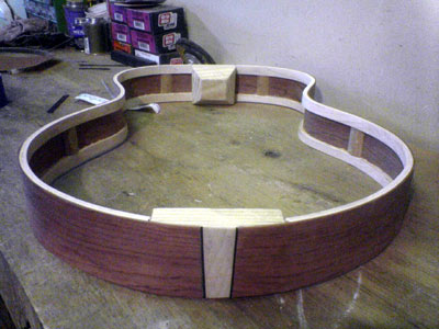

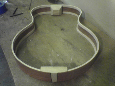

Ok campers, I've started on my second archtop. I am using Bubinga for the back and sides. The sides bent beautifully after sanding to 0.070" and using my modified fox bender with two 200W bulbs. I thank all who responded to my earlier Bending Bubinga post. However, after finishing the rim (including the end graft), I noticed that something was missing. I had installed the solid linings without installing the side braces first. Will side braces between the linings be sufficient? Anyone got any suggestions on correcting the problem?
Thanks, Chip

Allrighty then.
After careful consideration of all of the suggestions, Hank's suggestion of the small braces from lining to lining seemed to make the most sense to me. The other methods, were just a little too tedious for what I wanted to accomplish. Here is a photo of the end result. After I get back from Chicago, I'll glue the back plate to the rim.
Chip
Fixed!
