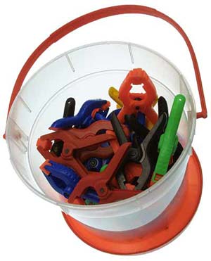

John, I'm using small spring clamps with swivel heads. More expensive than building the Taylor type but they work well.
Spring clamps

I don't know anything about the Taylor clamps, and I am new to building. But I just glued some kerfed linings into a soprano uke using small spring clamps purchased here: Mini Spring Clamps. They worked pretty well for me. I found some similarly sized spring clamps at my local Home Depot for a little more money (the vinyl on the HD clamps is yellow, vs the black on the clamps from the link above). The HD clamps were OK, but the springs in the ones from Papa Johns Toolbox are little stronger.
I've got some of the mini plastic spring clamps with the swivel pads. I'm sure they vary by manufacturer, but the springs in the ones I have are sort of weak. TomS38422.7733217593

I'll second what TomS says. Those plastic ones are weak, and aren't strong enough to press the lining solidly against the side if there are any gaps. Plus, they kept breaking on me. The meal spring clamps, otoh, are great, and all I use these days.

That is what I'm using mainly too. The metal 1" spring clamps. They work
well, but I would love to have something to get a little tighter, as well as I
just like getting more tools ;)
