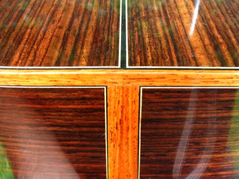

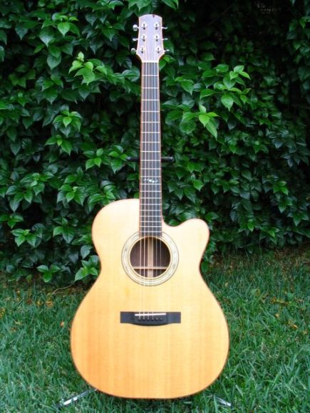

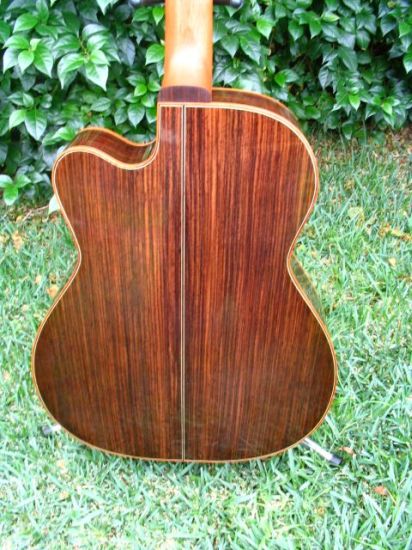

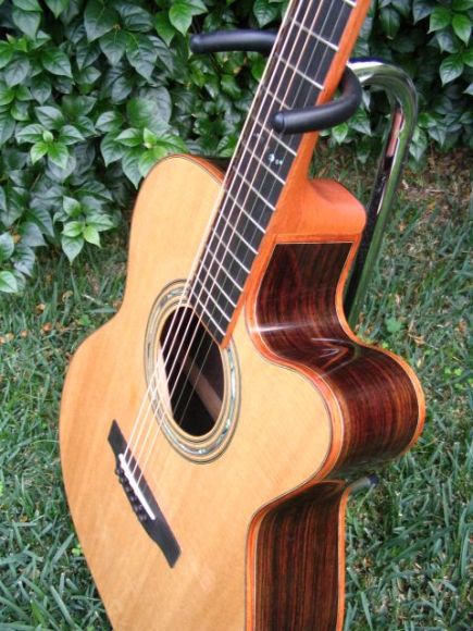

Well I finished my first last night, kinda feeling a bit numb now (is this normal?). At some point last night my woodwork project became a musical instrument. I'm really pleased with how it turned out, far better than I imagined it would when I started. It's not perfect, but then I don't supose many first guitars are. Well, the details:
Built as per Cumpiano, with the addition of a cutaway that was described in Benedetto's book - adapted for a flat top. The top is AA sitka that has started to look a little streaky since it was finished (not that I mind). Back and sides are EIR, the binding is New Guinea Rosewood. Neck is Brazilian Mahogany. It sounds marvelous, but I may be a little biased.

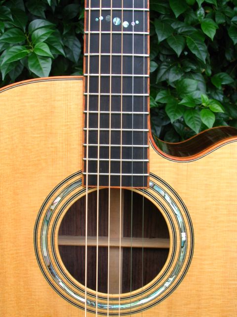

Paul, who you trying to kid? That is an incredible looking guitar. I really like your inlay at the 12th fret and the binding looks great. Can't wait to see your second. Don A38467.0419328704

Wow, I can't believe this is your first! It is beautiful! Beautiful Rosette for a first time, and a venetian cutaway too? You must be a glutton for punishment. Great job on the miters too. I don't think mine will look this good after the 10th!

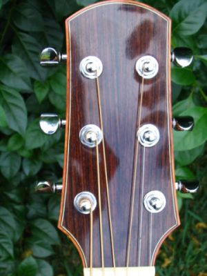

Good craftsmanship Paul! How about a shot of the headstock too.
Is the neck finish satin?

Terry, yes it's a matt finish, ragged on. I don't know how many finishes I tested for the neck before I found one I was happy with. The one I went for is a locally made polyurethane. I simply wrapped a rag around my gloved finger, dipped it in the can and rubbed it on the neck, lost count at about 12 coats and kept going for a few more after that. Just enough to fill the pores, then lightly sanded with P400 grit and then OOOO steelwool. Feels nice and fast. The headstock isn't the worlds most original, but it was one I liked. Here's the pic:

Wow!! Blows my first guitar away. What kind of finish is on the body?

WOW! Mitred purflings, bound neck, bound headstock, shell rosette, cutaway...for a 1st guitar! This is just fantastic. Congratulations and I can't wait to see your next efforts.

Excelent! Very nicely done! So - it may be your first guitar but WHAT ELSE HAVE YOU BUILT! Your workmenship is fantastic! Nice joints at the butt - rosette looks great! Miters are perfect! Yah like Don said Who you trying to kid! Sandbagger!

Colby, the finish is FP, and was a huge learning curve for me. I don't think I'll FP another one. I was once an industrial spray painter, so I'd rather use the skills I already have, and spend more time building.

I think I will have to get Benedetto's book and look up how he does a cutaway.
By the way, how did you bend the sides? Did you build a bender or go freehand?

Thank's Josh, Yeah I built a bender. I saw a web page where someone was building one, they had a blurry photo of the plans, couldn't see the measurements, but I knew how big my guitar was going to be. Once I could see how it went together and how it worked, it was easy enough. I'm just using 3 x 100W light bulbs and augmenting that with a heat gun when I need more heat. I'd go with a blanket, but I can't find any over here, and we're on 240V mains power so I can't use one of yours.
The sides were easy to bend, but I went through a lot of bookmatched binding strips that kept breaking at the cut away, until spied the hot air gun across the workshop.
