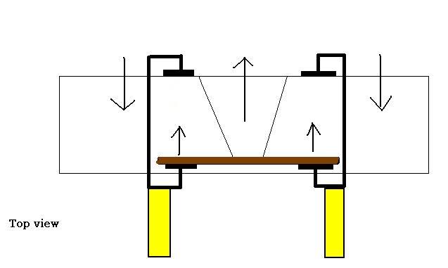

I had to remove a neck on one of my guitars this past summer, it was a dovetail. I didn't build a jig, I simply took two quick grip clamps and a small piece of wood. The wood went across the heel cap and the clamps pinched from the top down to the wood stick providing an upward push.
Here is a quick and dirty drawing to explain.
LanceK38444.2861111111

Lance, I really like your clamp method. I'll give that a shot. Simpler is always better!
