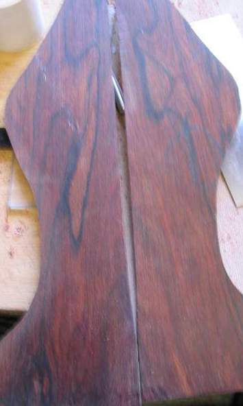

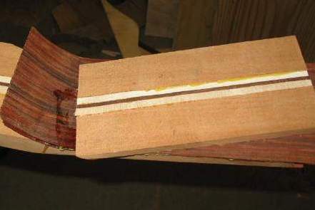

Yes the rosewood plat in the picture is a bit thick. That was one of my first guitars and I now thin it out more. There is not special trick to getting a clean bend. Practice I guess. I bend everything freehand so I don't usually find it that difficult. The only wood I have had some trouble with has been cocobolo. It didn't want to take the bend real well, but once glued and clamped it stayed just fine. You could use friendly plastic to make a caul, or you could do like me and use the offcut from the back of the headstock for you caul. Like so...

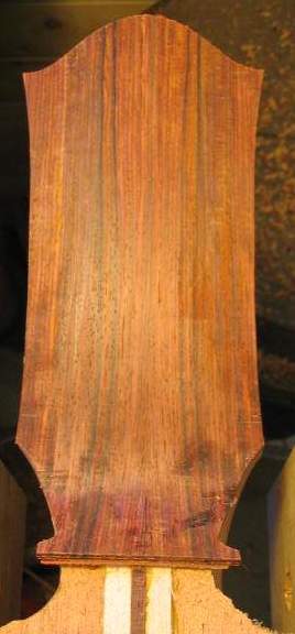

This is what it looks like when it is done.
Also to get the plate for the back of the headstock I use the off-cuts from the back. I glue them todether with CA to get a book-match.

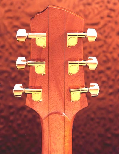

Here are some of mine
John How38440.5612962963
PostPosted: Tue Mar 29, 2005 5:03 am

Very nice John!

Very nice John and very simular to one im using on my next guitar.

Isn't the primary purpose of the volute to strengthen the neck shaft to headstock transition?

Yea I think you are right that the purpose of the volute is to strengthen the neck shaft. I think it is strengthened even more if you put a back plate on it as well. I think the secondary purpose for putting one on is that they look really cool.
