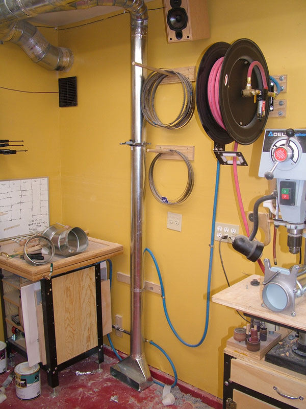

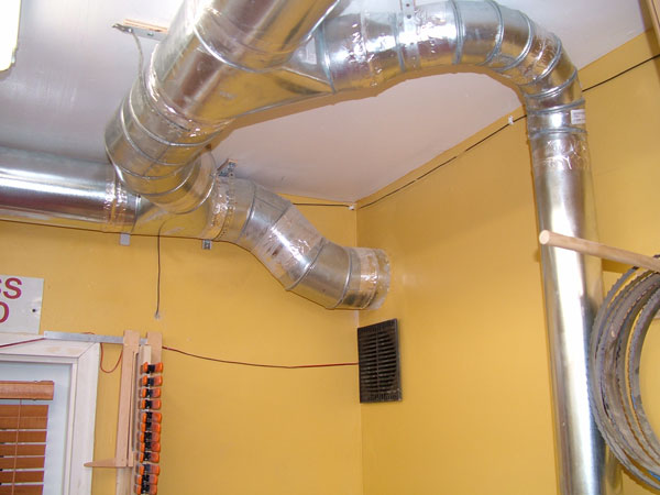

Let's start here, this is where the ductwork comes into the shop from the outside shed, the black grate is the exhaust that lets air back into the shop, I ran two 7" pipes to accomplish this. But it works and you get quite a breeze from the exhaust.
This is the floor sweep, it allows me to sweep the shop into the dust collection system.

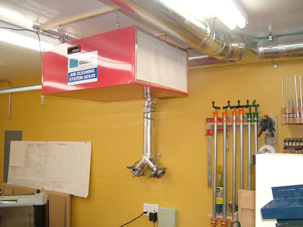

This is the ambient dust collector and on the wall is a double gate unit for hooking up to the rolling tables. The system is writed so that when you pull a gate the Dust Collector comes on automatically and off when you close the gate.

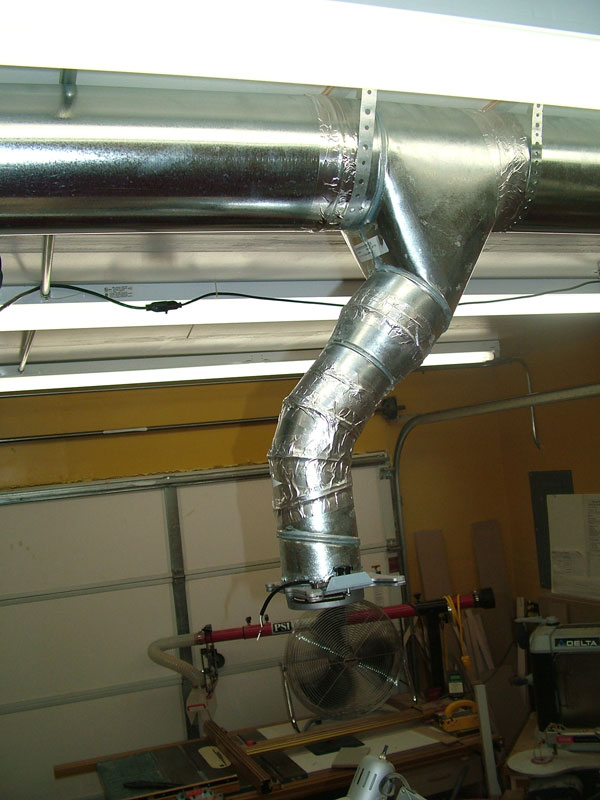

This is the ductwork running across the shop to the CNC table, the end is open because I need another part to finish this section but all the other pieces are done and ready for the part when it arrives.

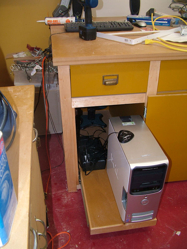

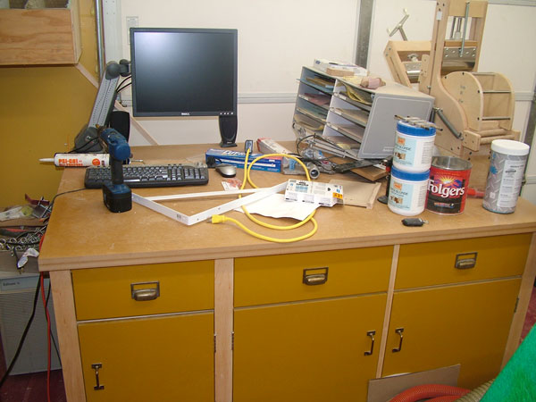

This is the new CNC table, it's storing junk right now while I finish the ductwork, but the computer is installed and working

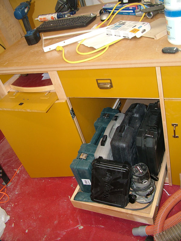

It has storage for tools and drawers for CNC parts.

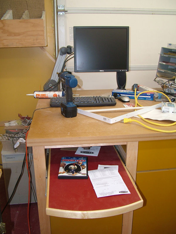

It also has a roll out shelf for the computer, and a sealed door when closed to keep dust off the PC.
The 'Drawer' above the computer is actually a pull out shelf for a small wireless keyboard (on back-order of course).

The only thing I'd change is the peg board. (I really hate that stuff) I've never bothered to figure out a good way to keep the tool pegs from falling out or wearing out the holes & getting wobbly.
I like the security of a sheet of ply or MDF with nails or screws & those nice rubber coated, screw-in, hanger upper thingies.
You mentioned rolling tables... I assume they are perforated for dust collection??? got a pic for us?
I'm just finishing one for my shop but I want it mobile, so i'm planning to install a dedicated shop-vac under the table.
I REALLY like the wired blast gates! Beats the heck out of running around closing all the open gates & turning on the collector. I'd use the collector a lot more (for those quick jobs) if I had your set-up!

[QUOTE=ToddStock] Very cool - next time I move, I am def doing the purpose-built shop.
Looks like you have a pretty good start on it, but consider cleaning and taping ALL bent metal seams (e.g., swivel joints in 45 or 90 degree turns. A large system can loose a surprising amount of aggregate CFM from fairly small leaks. You could also smoke-test the joints with the stuff that insulation installers use to find window/wall leaks, and tape the leakers.
FWIW, I clean even ABS or PVC ducting with naptha prior to taping, and that seems to do the trick on longevity.[/QUOTE]
What you don't see in the pictures is that EVERY single joint is sealed with silicon that PSI carries, anytime I have a junction it gets silicon and then metal tape to make sure it does not leak. I've done things like the sheet metal screws are always near the top out of the path of debris (where possible) and all straight pipe joints are up out of the way. I opted for the economy ductwork, if I ever do this again I'm going to use the good stuff. Nothing wrong with the economy stuff, but everytime I make a corner I have to silicone it and let it cure, it's a pain...

[QUOTE=Daniel M] Very Cool Shop Paul... I even like the colour!!!
P.S. Where'd you find the cool air hose reel? I need one of those bad![/QUOTE]
Thanks for the kind words.
The rolling tables are for tools, there is another post from me that gives details on them, almost all the tools in the shop are mobile at this point. I haven't done a sanding table yet but it's in the plans...
The Airhose reel came from Harbor Freight, it's total overkill as the line is 3/8" but they didn't make smaller reels with the retractable wheel. I was tired of tripping over air hose and the hassle of rolling it up, it's a monster unit.
