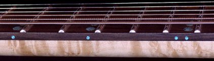

I've been making somewhat similar fretboards, at least in the outcome--mine are patterned on the old Fred Van Eps scalloped flush fret fingerboard. I use rectangular SS bars instead of round, and the filets are in the fingerboard material itself. I glue mine in with CA, but epoxy would work well too. These fingerboards play like buttah...
The fingerboards I remember of Richard Schneider used Delrin bars (they were nylon string guitars) and I don't remember any filets.
Dave
These users thanked the author ballbanjos for the post: Stuart Gort (Wed Aug 25, 2021 2:38 pm)

Nice, Dave! Do you scallop by hand using drum sanders? I can't imagine trying to fine sand that thing.
PostPosted: Wed Aug 25, 2021 1:42 pm
Joined: Fri Jun 22, 2007 11:14 am
Posts: 1048
Location: Newland, North Carolina
Last Name: Ball
I have an original Van Eps board that Fred made with sanding drums, but I modeled mine in Rhino and cut it with CNC. Very little sanding left to do, but what there is I do by hand.
Dave

On the scalloped fingerboard, how are the frets removed if needing new?
PostPosted: Thu Aug 26, 2021 5:15 am
Posts: 1048
Last Name: Ball
Heat with a soldering iron and tap from the side far enough to get an end to stick out, then carefully lift the end. In honesty, I've never had to do it on a real instrument, the wire is hard and wears well. Not nearly as hard as the rods that Stuart is using though.
Dave
These users thanked the author ballbanjos for the post: wbergman (Thu Aug 26, 2021 11:28 am)

Epoxy sold as "toughened" will be fine for this application. The variables are mixed viscosity, optical clarity, open time, cure time, and absolutely Tg (glass transition temperature). That tells you at what temp it will release the bond.
The viscosity is important. I want to use a syringe to apply the first beads of epoxy along those fillet areas with de-gassed epoxy. So here I need a low mixed viscosity system that will open long enough to de-gas, get it in the syringe, and apply.
Look for a "toughened" epoxy that cures at room temp overnight. I want one that stays open for at least 45 minutes and releases at no less than 180F and no more than 250F. I want the mixed viscosity at about 1000. It could be 500-1500+ and still work. I also want it as clear as possible. Cause when it's polished up together with the frets....it'll look quite ich. People that look closely will have more to see.
I read Emerson on the can. A foolish consistency is the hobgoblin of little minds...true...but a consistent reading of Emerson has its uses nevertheless.

Chris Pile wrote:
I've considered the stainless rod idea, too - I've just been too busy with life to even experiment with it. But since it's not my original thought, and others are giving it a go, then I conclude that it has merit.
I use 17-4 stainless pins (they have to be made on a lathe) in my bridges...I've seen no wear enough to tell me not to use it for frets as well.
But then I thought, "I have some drill rod. High speed steel. Shiny. Can I dress it with a diamond file?" Yes.
"A HIGH quality file"? It's hard but...yeah.
Can you polish it? Oh yeah....all the way downtown.
What is the Rockwell C hardness of 17-4? 36. The drill rod? 64. I choose this initially because...why not try a different alloy on one guitar and then see how it feels and sounds. Then if I hate it I get to practice the thing I preach. I get to remove all the frets and re-fret with a new alloy. Beat THAT for a design feature....you can change fret alloys on a whim...lol.
StuMusic
