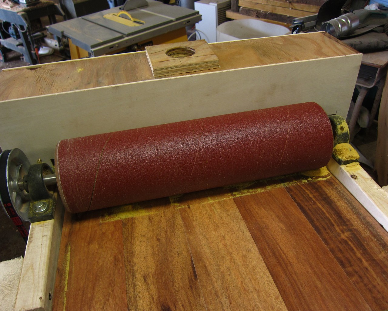

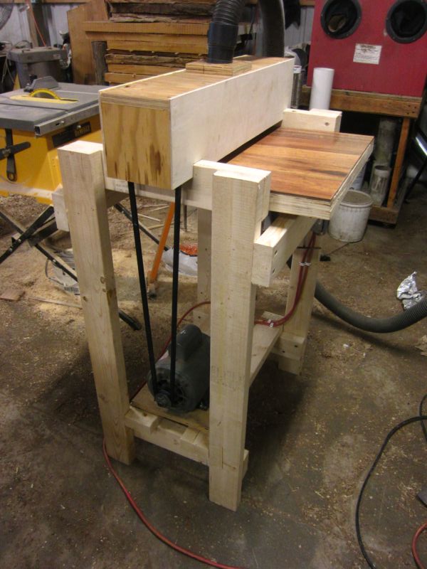

Much thanks to Pat Hawley and Matthias Wandel for making the plans available!
One thing that might be helpful to put in the plans is what size belt it takes. I used a 64", but would probably go with 63" instead.
I used a 3/4 horse motor, because that's all I had on hand, except for a 1-1/2 horse, which would have been overkill. ;)

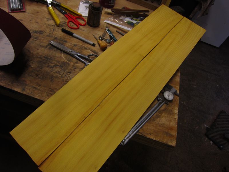

I decided to try it out on something cheaper than rosewood, so here's a set of osage orange I thicknessed to .080":

How wide did you build it and what is your steel shaft diameter?
I am hoping to up-grade from fourteen inches wide to thirty inches wide to thickness a double-bass.

The drum is about 19" wide, and I used 3/4" shaft. I would have preferred 1", but I already had the 3/4" pillow bearings.

I need to make one too. I like your wood on the tabletop. How dusty are these things to run? I suppose it depends on how much suction you have.
:) The table surface is leftover laminate flooring from my bedroom. Nice to have tools that match the decor. laughing6-hehe
It's not too dusty. Here's what it looked like after sanding the osage:
http://www.pattonblades.com/41011-4.jpg
My vacuum needs a new bag, and isn't sucking that hard, so it would do even better.

Hey nice job on your sander. I'm wondering about the shaft, is it any special designate type of steel? All I've seen around here is some rusty weldable round rod, not very round or straight, diameters mike out all over the place, and comes in 21 ft. lengths so you can imagine how bowed up it is.
Maybe you or someone can steer me to some high quality shaft material, nice and round high rpm stuff.

RustySP wrote:
Hi Phillip,
Rusty
Hi Rusty,
I used TG & P (turned, ground, and polished). Its made specifically for using as shafting, so it's made to much tighter tolerances than cold rolled or hot rolled. I got mine from Metal Supermarkets, and they were charging about $5 per foot.
I couldn't find it on their website, so you'll have to call your local store and see if they have it.

Nice Job on the sander [:Y:] Obviously I am not seeing the entire picture here , how does the board feed and what stops the force of the sander from spitting the boards back at you . Can you show a few more pics ?
The wood is fed in by hand, and steady pressure is what keeps you and the workpiece from becoming joined at the hip. ;)
I'm toying with an idea for a hand cranked feed conveyor which would be a nice improvement, but this still works.
I have a bunch of in-process pics of the sander in this thread:
http://www.bladeforums.com/forums/showt ... ect./page2
If you can't see them, I'll copy them here.
Wud, mine is of similar construction (manual feed). It really is more effective than you would guess feeding by hand. The trick is to feed slowly and evenly and take off small bites at a time. I positioned mine such that (unless I am doing a very small part) I stand on the side and feed in with one hand, pull out with the other. When I get to the thickness I want, I do several passes at that setting and things come out pretty darned even.

I mounted mine on an old barbecue frame so that it is mobile.
I used a hip-roof on the air hood to improve air velocity over the drum.
I use sliding doors, front and back, to control air velocity entering the hood.
I like the structure of your stand, it looks solid.

The doors are just flat wood mounted on the front and back vertical faces. They are slotted to accept thumb-screws into tee-nuts in the face. They slide up and down on the face and are held in place by the thumb-screws.
When I start sanding, I set the doors with about an eighth inch of clearance above the wood on the feed-side and about a quarter inch on the back-side. This provides good air velocity to keep the dust in the hood at the feed but gives enough mass-flow of air to carry the dust through to the shop-vac. The slots allow adjustment for thicker or thinner wood. My sander has a maximum thickness of 0.35 inches, my new one should handle 1.5 inches I hope.
