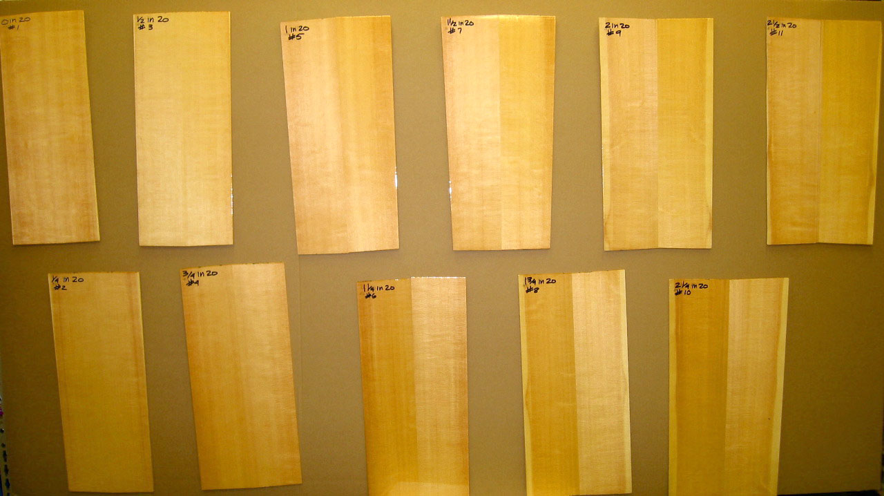

Here is an image taken from the ANZLF discussion on runout:
http://www.anzlf.com/download/file.php? ... &mode=view
It shows how the "harlequin effect" (good term for it Alan) increases as runout becomes more pronounced. They show it in a unit dependent measure where I find a ratio more useful ( 1/4in. in 20ins = 1:80 , 2in in 20 ins = 1:10)
