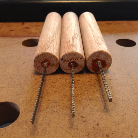

What tools do you guys use to do string slots at the top of your bridge pin holes? SM has job specific tools but as usual they seem pretty high.
Just wondered what you all used.

Different thicknesses of jigsaw blades ground down at the back and fitted with a handle for initial slotting, refined with a 5.5" Bahco Round Needle File.
Cut the string ramps with dremel and round bits.

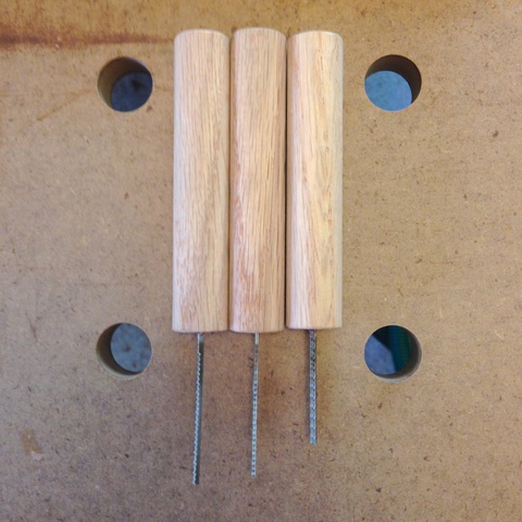

I had used homemade jigsaw blade style slotting saws for a couple years—they work, and will get the job done. But they have a tendency to grab/jump.
I finally picked up the two sizes from Stew Mac, and if you are going to do more than a few bridges worth of slotting, they are absolutely worth it. The teeth on theirs are symmetrical triangle teeth, negative hook angle—they cut slower, but much smoother than the jig saw blades I've used.
If you could find jigsaw blades with very low, or negative hook angle, those would work best.

I use an old coping saw blade, then triangular then round needle file...

I got one from SM many years ago, probably 20 years now, and still use it. It looks like it was just a jigsaw blade mounted in a handle though. The pull saw option seems like a better idea though.
