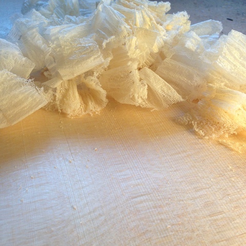

I have an old Powermatic PM160 16" planer with a Shelix head.
I use it in conjunction with a carrier board to thickness backs, sides, and tops.
It's about 10X faster than the sander but there are some dangers. If the piece isn't securely attached to the carrier board or if the double stick lets go for some reason, it will eat the piece of wood. I have experienced tear out on highly figured Koa [headinwall].

Thanks Kevin, that is exactly the input I was looking for. I'm ok with assuming the risk of chewing up wood here and there—generally I don't build with high end wood to begin with; and I'll be sure to pay close attention to the feed rate. It's just good to hear it is at least *possible*. The budget for a planer+drum sander+dust collector would take 5 years to materialize…I'm patient, but not that patient. :D

When looking at insert style cutterheads like the Shelix, keep in mind that they are not created equal. There are many knock offs where the edges of the cutters are parallel to the axis of the head. These do not produce a shearing cut. If you've only used straight knife planers, there is a huge difference when going to a Shelix.
I've planed curly and quilted maple, figured Sapele, figured cherry, Wenge, Padauk, Amazon Rosewood, figured Cocobolo, Koa, Ziricote, Osage and other woods with the Shelix and the only one that tore out was highly figured Koa but YMMV. Of course sanders never tear out but they are painfully slow if you actually need to thickness not to mention the joy of clogged belts with oily woods.
Disclaimer - my Shelix is in a very heavy old planer with no vibration. I don't know how well a benchtop machine will perform even with a Shelix.

The best low-dust option (and can be more budget friendly) would be to use a hand plane and/or scrapers for thicknessing tops/backs/sides. It can actually be faster than a drum sander on some woods, gives you a chance to get to know the grain (runout, curl, stiffness, etc)
A good cabinet scraper, a #4 or low angle jack plane, sharpening stones/film of your choice, and a jig for sharpening makes for a great thicknessing setup.
Drum sanders are wonderful tools, but I would suggest you want to invest in the full setup. A a planer is not liekly to give you the control you want for thicknessing delicate tops/backs/sides.
Thanks for the input! I have attempted to use hand planes and a scraper to get the stock down but I found the process of thicknessing (especially the sides/backs) to be time consuming and cumbersome. Some of this may be traced back to human error on my part, but I could not seem to get certain woods to plane well. Low angle plane with an extremely tight mouth, super sharp iron, etc. It was still maddening. When I was finally able to avoid tear out it was taking a shaving of .002" or so, which makes removing any significant amount a *long* ordeal. :-/
Using hand planes efficiently requires some knowledge and a few planes though nothing too fancy. I can hand plane a walnut back to thickness and scraper finish it in under 15 minutes. Obviously longer for rosewood. Having a couple of spare blades helps, sharpen all blades before thicknessing (super sharp) so you aren't breaking off task. You also need some way of removing material fast. That comes down to a jack plane or a plane with a cambered blade - what I term a gentle scrub plane. I use a wooden plane for this because they are lighter, less tiring in use. Finally a smoothing plane with a closely set chip breaker. The rest is just knowing which direction to plane and having an efficient way to hold the material.
