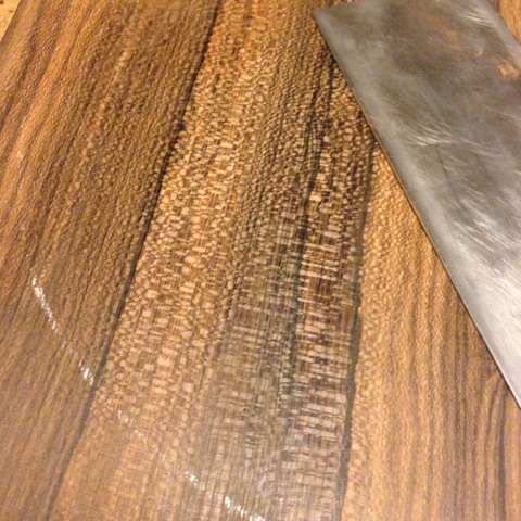

Hi all,
I recently had a birthday and I want to build something special to commemorate the big 4-0...
I found this Ziricote... I've never worked with it and have found most people find it a PITA to work with. Chips, cracks, the whole nine yards. I recently got a Fox style bending machine along with a silicone heating pad.
I'm always up for a challenge, but am I just asking for trouble?
Also, I'd appreciate any input on the wood... I love the look of it, does anything concern you from looking at the picture? Questions I should ask the seller?
I should add, I want to build a cutaway....of course
Thanks for any advice!
RaúlImage
Sent from my R1 HD using Tapatalk

I've only built one with Ziricote, but I love it as well. My first concern with the set pictured is it looks decently flatsawn- which may exacerbate ziricote's inherent problems.
When I built with it, I flooded all pieces with thin CA prior to bending/jointing. This helps with stability. It's a nasty process and adds some noxious fumes to the bending process (plus will require barriers between the wood and blanket/slats), but helps to fill any small internal issues you can't see.

I'm another fan of ziricote. I've only built one guitar with it so far. The back and sides set I used presented none of the problems on your list, but maybe I was just lucky. The only thing that stood out was that the sides took more effort to bend on my hot pipe than other woods. I pre-treated the sides with SuperSoft and they bent without cracking or cupping.

About 70% of what I've read online talks about those problems... The rest say they've bent like butter. SS is a product that seems to come up a lot for a successful bend.

I think I might build with ziricote for my own use, but never commercially...we've repaired too many cracks not to understand why the wood deserves its reputation.

I've only built one with Ziricote and was fortunate to have a set that bent like butter. Would love to use it again.
Thinned sides to approximately .080"
Light misting with water on both sides
Wrapped in kraft/butcher paper
Sandwiched between two metal bending slats
Heated my silicone blanket to roughly 300°F
Was patient with the preheat
Bend smoothly with no cupping/splitting or creasing.
Planing the back/sides to thickness was the only area I needed to exercise caution. Use a very sharp smoothing plane on a skewed angle or cabinet scraper as its very hard and almost crumbly. If my plane was the least bit dull I would get slight crumbly tear-out.
With a sharp plane or fresh cabinet scraper it finishes like glass.

I've built one and just closed the box on a second ( a commission) it bends OK, I bend it @ 295 and that seems plenty.. Cracks and splits easy until closed up then seems fine.. I don't flood with CA but do use a few extra side braces.. My first was for me and it is 4 years old no issues just left sitting on a a stand..

I had none of the problems expressed and did nothing differently than I have with mahogany or EIR.

I've built two. The first is 4 years old the second 3 years old, no issues with either one. Both sets were well-seasoned, no problems with splitting nor bending. These were steel string, but I'm considering a classical or two with Ziricote.
