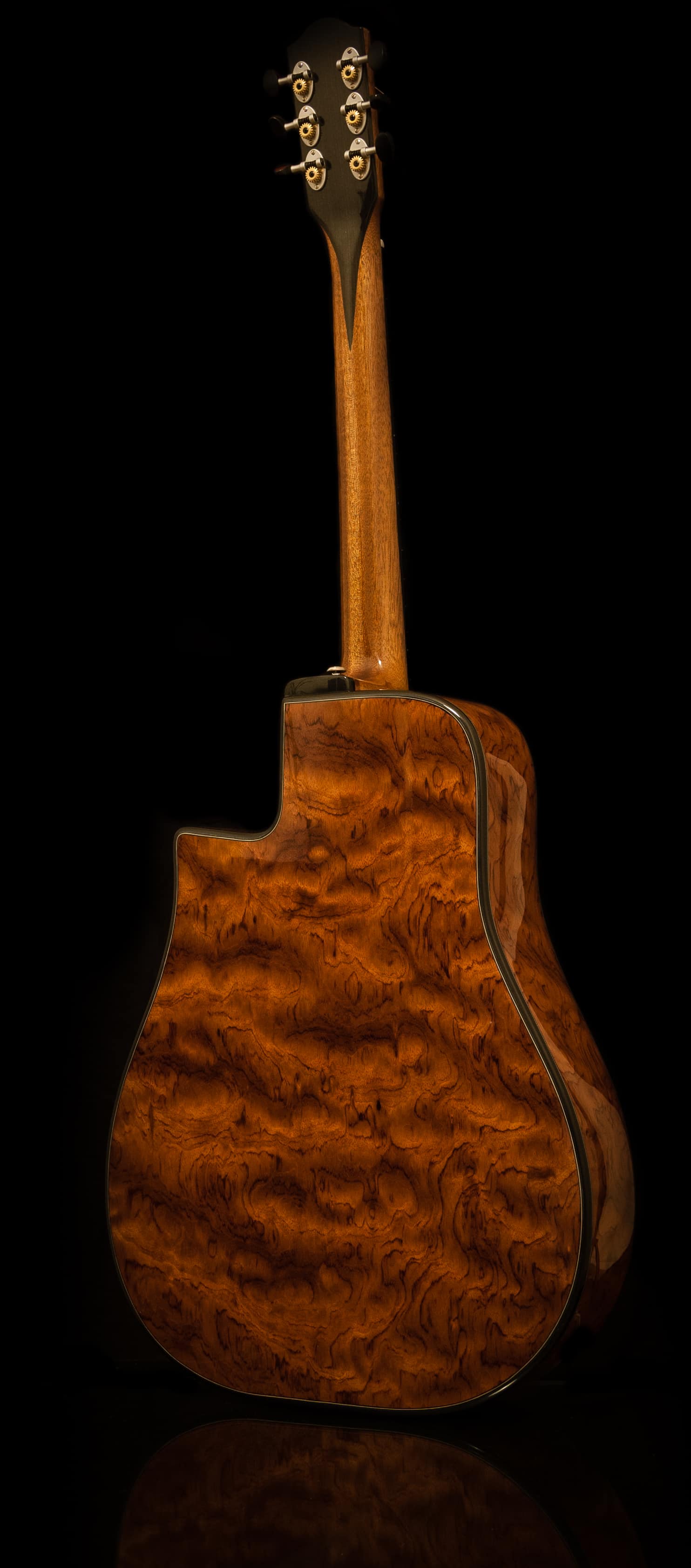

I've laminated many backs. These days, I do for all my more expensive work, I use solid for my cheaper guitars! The bottom line is - if you want to do this more than once, get a cheap vacuum bag set up. Once you do, it becomes very simple.
For core materials, you can use whatever you like. Nomex will make a lot more work and may even make a inferior back. A few Classical makers have done this, and most have abandoned this approach. My first few laminated backs, I used reject soundboards as the interior core. The main thing is, if you are concerned about stability of your outer material, you do need to make this "posh ply" to some degree. You can cross grain with cheap mahogany veneer, or with a material like silk or I've even used shoji paper.
If you really want to make a lot of work for yourself, you can laminate an arched back!
The process is something I may well make a video about someday, but that back is a laminate of spruce, maple and bubinga veneers. Looks nice though...
Glues - use whatever you like. Some like epoxy, some unibond, some PU, some titebond. They all work, they all have pros and cons.

Beautiful work Nigel. I've been thinking about doing the radius bindings. Any pointers on that?
When I see all the flat sawn 'Highly figured wood' (stump wood, crouch wood, etc.) used these days I am always surprised that more people don't laminate. How thick do your backs typically end up when all is said and done?
Joe Beaver
Binding - double up. Simple as that. Two layers of whatever you are using. Avoid maple for obvious reasons. Then go around with a radius bit in your binding jig. Much quicker to level these sorts of bindings.
Yep, using stump wood is pretty much asking for trouble, but that doesn't seem to stop folk.
Back thickness is down to you. Mine vary according to what I'm using. Often around 4-6mm. With a heavy radius. So my backs are dead.

One piece backs anyone? Well, 5 pieces to be honest...Even when working with solid wood, I'd been making instruments with "dead" backs for years without knowing it. It was Trevor Gore who told me I was!
Dead is dead, so it might as well be pretty.
And yes, these are more stable than solid wood backs for sure.
For me, and for my work, this way of working really suits. It's not for everyone, but then, what is? Also, it's not without issues - binding becomes even trickier - imagine that?
nigel
