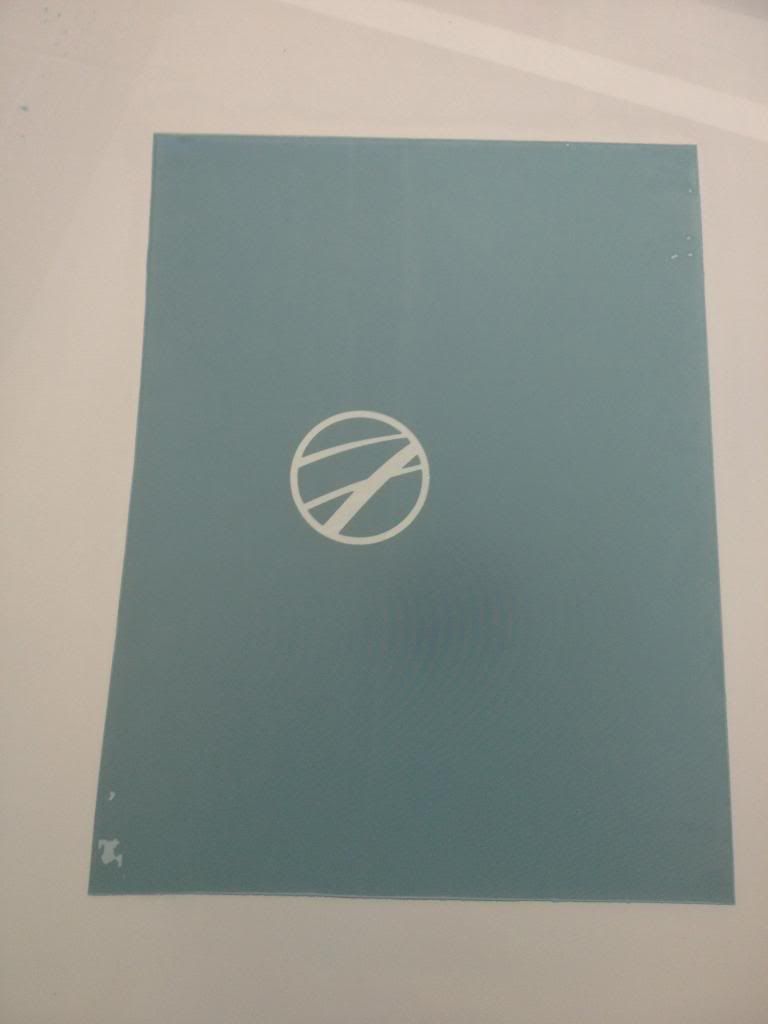

I did a lot of research on how I was going to do my headstock logo on my first two scratch build guitars. I would have loved to have done an inlay, but I'm quite nervous about doing inlays so I shied away from that. I was also thinking about having a decal made, but wasn't sure if the edge of the decal would show under the lacquer. And then the idea hit me - silkscreen the logo on. And silly me, I had a silkscreening machine down in my basement from another endeavour of mine.
So today I finally got my two necks to the point where I could finally tackle trying to silkscreen on my logo.
First I created the screen itself. I resized my logo to the correct size and created the logo in the screen.

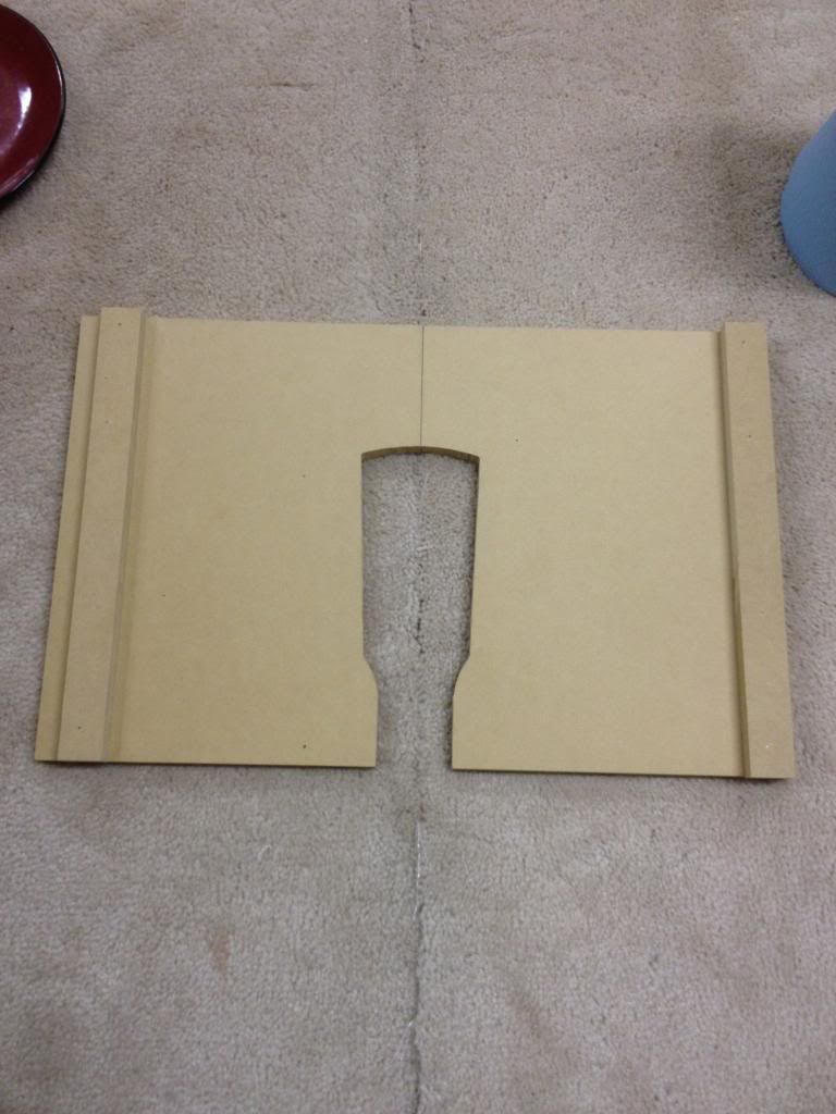

After I made the screen, I made a custom jig for the screen to fit into that holds the headstock in alignment, and prevents it from moving.
Here's the screen in the jig. What's nice about doing it this way, is that the jig allows you to slide the logo up and down the centre-line of the headstock until you get it in the perfect position. Once I found the perfect spot, I used a piece of tape on the screen so I can line it up in the same spot every time.
Next I put the neck in the jig and silkscreened the logo in a gold colour. What's nice about silkscreening is that you can make it any colour you want :)

I never screen printed on wood before but I did some research a couple of months ago on printing on wood. I plan on printing on a pair of wooden eyeglasses that I'm working on. I used to screen print professionally, but I don't consider myself an expert.
There are a few company's that make screen printing inks that are specially formulated for printing on wood, plastics, metals and glass. Nazdar 59000 series inks should work just fine on wood. The good thing about company's that make screen printing inks is that for every ink system they sell, there is technical data that explains how to use the inks. The technical data also indicates what kind of stencil to use, what solvents to use for clean up, mesh count recommendations, squeege durometer etc... For a head stock logo, I personally would use a solvent resistant capillary film stencil instead of applying a liquid emulsion, even though a solvent resistant liquid emulsion will work just fine. Capillary film is made to a certain micron thickness by a machine and is a applied to a clear backing film, so the stencil is more uniform through out. Also, It's easier to apply to the screen, and isn't messy like liquid emulsion. You will also produce higher resolution prints using capillary film which is the main reason I use it. When I screen print on fabric I only use capillary film. It is more expensive than liquid emulsion, but some distributors (Victory Factory Jamaica Queens, NY) sell small amounts for under $20 (I think it's about $12.00 for a few sheets).
The Nazdar 59000 series has an air dry catalyst that is either pre-added or that the user can mix into the ink. No heat is required. The 59000 ink system also has a flattening agent to reduce gloss. I would first do all the pore filling sanding etc... then screen print the logo. I would test on scrap first. If you're printing on dark wood and want good coverage you may want to print an under base of clear or white then print your desired color on top so that the print will be more opaque, and so that no grain shows through. You would also need to choke the under base art work about 2 points so that it's not seen. You can also print the clear ink over your print to seal it. Another good thing about company's that manufacture screen printing inks is they have a tech department so that you can call and ask question before you order. One last thing that is trivial: silk is rarely used in screen printing these days. Silk is more expensive than synthetic fabrics, and not as stable, and is more difficult to reclaim . You can reclaim the screen (erase the image) by using chlorine bleach or a special screen reclaimer. These days monofilament polyester is the preferred fabric for screen printing, and can be stretched to a very high tension for superior print results.
http://www.nazdar.com/prodDetail.asp?ca ... oductID=62
