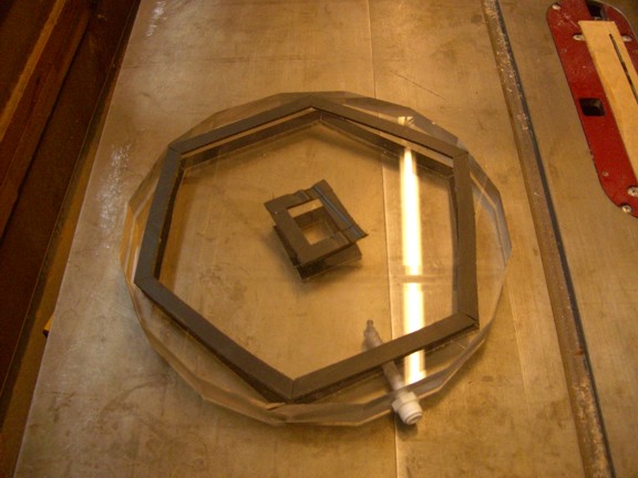

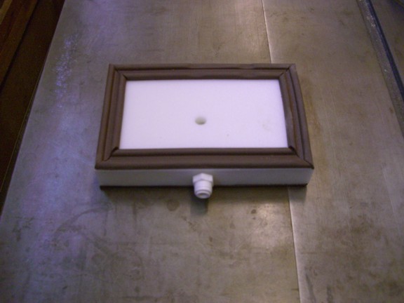

You can make your own vacuum clamps with a piece of wood, some foam-rubber door insulation strip and a cheap plastic pipe fitting (assuming you already have a vacuum pump and pipe...). You just have to drill a couple of holes and tap in the pipe fitting, stick the foam-rubber strip seal on both sides of the wood and you're in business. Cost is way less than the $6.25 you see on the 'bay!
I use them all the time for holding stuff down to my table saw for routing. I make mine from plastic/acrylic (cheap offcuts from my local plastic store). For example, here are some photos of a couple I made - a large round one for clock making, and a smaller rectangular one for general work:

Thanks Dave. I actually was just thinking about making them myself but i wasn't sure if there were specifics involved with building them. I have an old pump lying around that will hopefully do the job.
