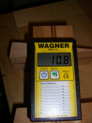

Here's the MC of a cutoff piece of neck blank to show what dry wood measures in my shop:

Thanks for all your answers everyone. I guess I'll keep them until they're dry enough to use and have a word with the vendor to let them know about the issue. They were less than $8 each, so not too bad a deal even considering they aren't quite AAA quality, and it's really not worth eating the shipping costs over.
Shane - correct, you really need 3/4" thick wood to get a really accurate reading (that's what it says in the instruction manual). However, I did some experiments a while back that showed that you can guesstimate the MC of wood as thin as 1/4" pretty reliably by adding an adjustment factor to the reading shown on the meter. For 1/4" wood, add 1.5%. For 1/2" wood, add 1%. These adjustments give me the MC to plenty good enough accuracy for my purposes. Any wood over 3/4" thick reads about the same as 3/4" thick wood. Since these EIRW fingerboards are just over 1/4", I should add 1.5%, which makes them even wetter than 32%!!
BTW, the Wagner meter I have is pinless (uses radio frequencies to do the measuring), so it's completely non-intrusive. I take it with me anytime I'm buying wood locally - it's great to know how wet boards are before buying them IMO.
Tom - The equilibrium MC varies widely depending on where you live and the season. 10.8% is the equilibrium number where I live (in San Jose, CA) right now. It's fairly high at the moment cuz it's the rainy season (joke :D ). It goes way down in the summer - to around 6 or 7%.
