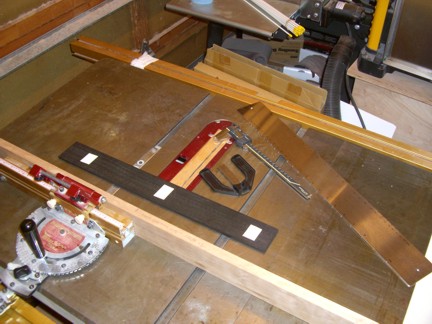

I wasn't able to do much for the past few weeks - too busy at work. However, I found time last week and this weekend to get on with my first guitar build (a scratch OM-ish thing). Here are some pictures. I decided to tackle making the ebony fretboard first. I used the StewMac fret cutting blade in my table saw with the StewMac fret scale ruler/pin. It worked like a dream - very smooth with no tear out.
Fret slots cut nicely:

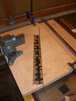

Then, using a jig that I designed a while back (to cut perfect miter corners on my marquetry pictures), I cut the side tapers on the fingerboard. This jig really made this task easy! I will probably make another version of my jig, tailored for fingerboard taper cutting, later.
...et voila!

Great! That's a nice a nice looking mitre gauge. Looks kind of Jessom like. I think a lot of people use sleds but looks like that would do the job just fine.

Danny V. - I love the Incra stuff. This is an Incra 3000 miter guage. It's adjusted to fit in the TS miter slot perfectly, so it's as accurate as any sled. I guess I might make a double-miter-slot sled at some point to make things just that little bit more accurate, but I will have to watch how "tall" I make it - the little 6" blade only raises so much in my 10" table saw!
