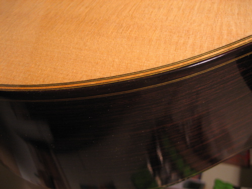

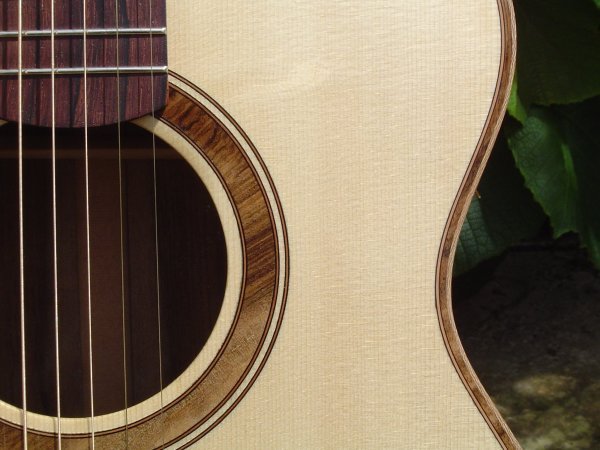

Ken, first you must understand that I come from the British tradition, where we tend to be more restrained in our choices. That said, I never use B/W/B or its variations, I find them just too in your face. Same of course for the shell variations. So what do I like, well I like to use natural wood where possible, usually the same wood as the sides. where I do use laminated purflings they tend to be B/fruit wood/B, which is more muted and if carefully chosen compliments the colour of the B&S.
This recent one brings it all together, the rosette is also matched, using the same wood as the B&S and purfling with ebony/pear/ebony. I like the whole guitar to come from the same colour pallete.

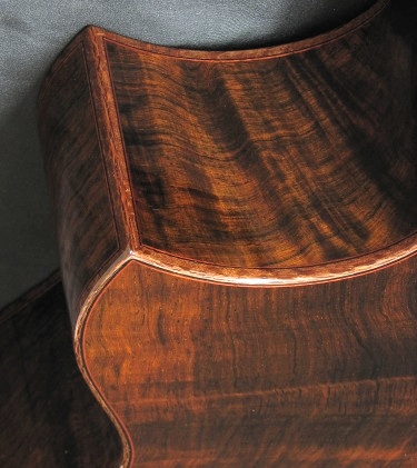

Making your own purflings is really very easy. I made these satinwood ones in no time.
Bob C sells the black fiber and LMI sells many colored veneers. I thickness the wood section and do a glue up of all the parts (the veneer and fiber come in .01 increments in sheets) then slice the purfling off with a 1/16 freud blade on the table saw. If you use titebond 2 or 3 for the glue up the purfs can be bent with no delamination. It really takes very little time to do and then you have something no one else has. The possibilities are endless!
Burton

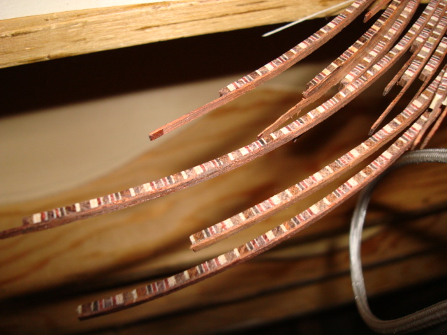

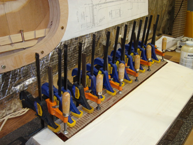

Ken, Sounds to me like you are ready to start making your own purflings as well as marquetry. Making your own will free you from relying on what (not much.....) is available from various supply sources.
Here are some that I sliced up the other night. This one is really simple, a veneer sandwich (use fish glue to glue up....you'll need the extra open time) consisting of East Indian Rosewood, Maple, Brazilian Rosewood, Ebony and Bloodwood in 1mm, .6mm and .3mm thicknesses. Slice and rearrange the slices longitudinally and glue to a backing veneer then cut into strips.
To use, prebend with heat  and use a single purfling strip of matching veneer on the other side of the strip when you put them on the guitar for symmetry.

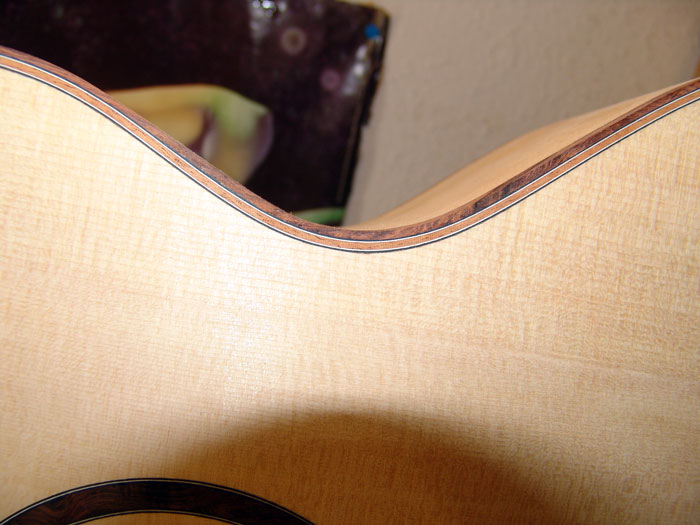

A bloodwood line can look nice in some combos.
http://www.chassonguitars.com
