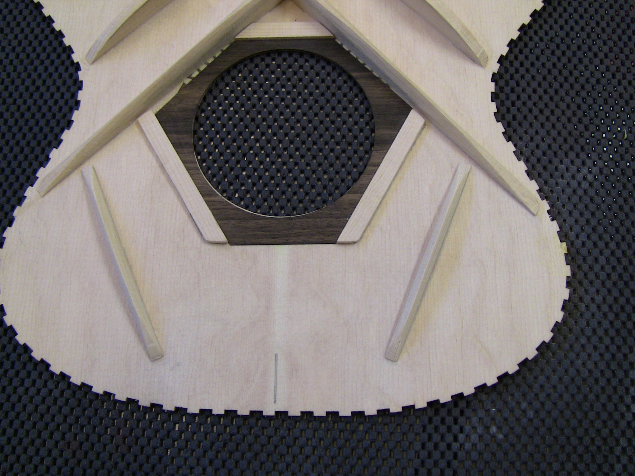

Here's what I've found works for me. No UTB, usual soundhole reinforcements, add two small braces parallel to the carbon fiber butress rods. Note, the braces on this top are still in the process of being carved and sanded, so they're a bit rough still at the moment.

Hold on Dave, I'm intrigued by your upper bracing and what you say sounds good, but, tell me about the box joint edging of that soundboard. Am I seeing things? :D
Joe
Hi Joe,
No, you're not seeing things. This was an experiment that I did a while back. I thought I'd try to laser-cut box joints on the edges of the top and back, and matching joints on the top and bottom edges of the sides. I spent a LOT of time working with the math/numbers to make them all fit together properly (with the sides curved so that they fit properly after they were bent), and it kind of worked. The idea was that I might be able to get rid of the kerfed lining (and reduce weight) and produce a guitar with a unique look. The problem I found with it, and have yet to solve, is that the sides need to be registered perfectly (to within a few thousandths of an inch!) - I could not do this with my Fox style bending machine as-is. I have some ideas for how I might design a new bending machine that CAN guarantee perfect registration and shape, but I have to find more time to work on it. Meanwhile, I decided not to waste the top and back that I did the box joints on. I'm using them in my latest prototype guitar (with my "bolt-in" neck idea). The box joint edge will be routed off when I put the bindings and slightly-wider-than-normal purfling on the guitar, and no one (except you and me) will ever be any the wiser! If I solve the problems with the box jointed sides idea, I'll let y'all know, you can bet on it.

Have you thought about just laying the top on the bent sides and hand scribing the the joints and cutting them by hand. So I guess you wont have any binding to protect the edges then? Also don't you believe the lining also adds strength to the rim and also helps to keeps the upper bout from deforming from neck torque forces? What would be the advantage of less weight of the linings as opposed to the strengthening of the rim? Isn't the advantage to solid linings and Fox's reverse kerfing lining the stiff strength of the rim?

Yes, I thought about doing it that way, however it's a LOT of work, and those little castle edges are fairly fragile and easy to break off (especially on the EIRW sides) - the chances are I'd break a few trying to cut them by hand. The next idea I'm going to try is cutting the sides from 3 or 4 veneers (laser-cut, of course) and then glue them up on a former with matching box joints cut in it (actually, in reality, probably a simple plywood form with acrylic sheets attached to each side, with the box joints cut into the acrylic) so that everything registers beautifully. Lack of time to do these experiments is my big problem right now.
As for the strength of the box and/or the sound differences, yes, sure, this will probably make a big difference. Structurally, I was planning on strengthening the box in other ways (CF is my buddy). Actually, I wasn't so much interested in the weight reduction as I was in how cool a guitar built this way would look. If it weighed a few ounces less than "normal" guitars, then that'd be cool too (just for bragging rights). Sure, the edge would be a bit more vulnerable to damage, and you'd never be able to remove the top or back again for repair, but so what? It'd be one cool looking instrument while it lasted, and who knows, it might even sound good. If it got damaged too much, I could always cut another one on the laser fast enough!

You can cut it with a router or table saw just like a drawer box joint. If you are afraid of breaking the cut from sawing by hand then I don't see that joint being very strong and not breaking and splitting along the grain unless you back it some kind of lining whether it be wood or CF. Have you ever seen Howard Klepper's Zipper or Dovetail guitar where he uses dovetail joints all over the guitar?
How and why do you think it will make a big differance sound wise?

The box joint edges are weak only until they are glued together. Once joined, there is a huge glued surface area, and the fact that the edge becomes continuous will ensure enough strength. If it needed small blocks or some CF, or even some kerfed lining to make it strong enough, then fine, I'll add some. Like I said, I'm not married to the weight loss thing. Actually, if I were to go to all the trouble of hand-cutting the joints, I'd laser-cut "doves" on the edge of the back and top, then hand-cut matching "tails" on the edges of the sides to make true dovetail joints - that'd be even cooler! Why would this make a difference sound-wise? Well, if the box joints alone are enough structurally, then I'll be increasing the size of the soundboard by about 3/8" all the way around (because there wouldn't be any linings). That, surely, will make a difference? Why not just wait and see? Surely it's worth an experiment rather than trying to shoot it down before I've even tried it?
If I'm not mistaken, Howard's dovetailed guitar is actually fairly traditionally built. I believe the joints are cosmetic and are for show rather than structure. However, I'm not at all sure about this - perhaps if Howard is tuned in, he'd care to inform us?
