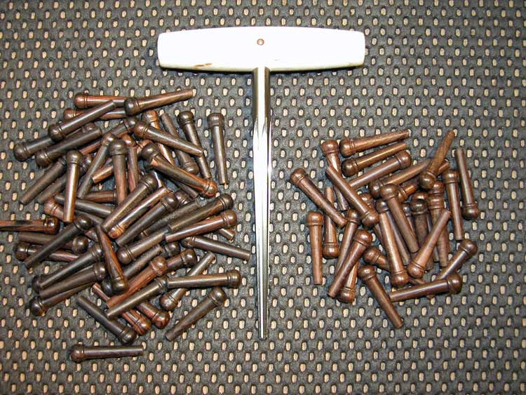

PostPosted: Wed Apr 27, 2022 4:09 am
Posts: 13631
Location: Ann Arbor, Michigan
First name: Hesh
Last Name: Breakstone
City: Ann Arbor
These users thanked the author Hesh for the post: Burton LeGeyt (Wed Apr 27, 2022 1:03 pm)
